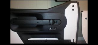

Not my door, but the best I can provide at the moment. There’s a switch on the panel, under the latch. I usually just use my key fob, if the Jeep is off. IMG_4307.jpg
Thank you.. Does just the drivers door get a switch? I can't remember. And I don't sit anywhere else.:thumb: You wouldn't happen to know the part numbers for the wiring harnesses would you?
Both driver and passenger get switches I just never cut the passenger side yet haven’t gotten around to it and I have a 2012 so it’s all different wiring harnesses. The rear is the same as far as I know please if anybody knows please let me know but the front are different if you have a 2012 I can get you the part number. They’re hard to find and stupid expensive
