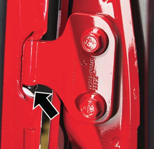

2. Starting on the driver side, open up your door and then use a Torx T-50 bit to remove the 2 screws securing it to the upper and lower outside hinges.
NOTE: The cargo tray under your rear deck is molded with holes that'll allow you to store your hinge pin screws.

Reinstalling your doors is as simple as following this write-up in the reverse order. To make things easier, you'll see that the upper hinge pins are slightly longer and they are designed this way help you guide the doors in place. It is important that you NOT over tighten the hinge screws as you can break them and they will only need to be tightened to 90 INCH lbs. of torque.
