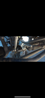

Had to make a quick fix before heading out tomorrow. Thanks to Jeremy @Disciple Off Road for helping me out as well as Synergy for getting it out so quick!
Glad to help! And glad it fixed your issues.Had to make a quick fix before heading out tomorrow. Thanks to Jeremy @Disciple Off Road for helping me out as well as Synergy for getting it out so quick! View attachment 423517
