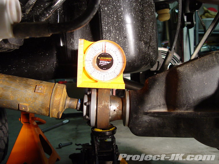

Your factory rear drive shaft uses CV joints on both ends and so it is not necessary to set your pinion angle. However, after you lift your Jeep, the angle of your rear drive shaft will be steep enough that your CV boots will be in a state of constant pinch. On a 2-door which has a much shorter shaft, this angle will be severe and the pinch on the boots will be significant enough to cause them to fail prematurely. Once compromised, nothing will prevent the grease from spitting out and that will fry the bearings inside in no time at all.
An aftermarket drive shaft that uses u-joints and a double cardan requires that you set your pinion so that it is in line with the shaft. Failure to do this will result in significant driveline vibrations. Left un-checked, this can result in driveline failure, pinion leaks or even transfer case failure. The only way you can set your pinion is to install adjustable rear upper control arms and setting them long enough that your pinion gets rotated up and in line with your drive shaft. Does this make sense? Here's a visual for you:
This is what your factory shaft looks like at the pinion before setting it...
And, this is what it looks like after setting your rear upper control arms so that your pinion is in line with the shaft. It is much easier to do this on your factory shaft and before swapping it out with an aftermarket one...
lol stealing my own thread but how do i get one of those ? idk what they are called but the item used to tell what angle it is at and what is proper angle on something like this?
Well, this is an old school angle finder but, any iPhone will do the job too :yup:
