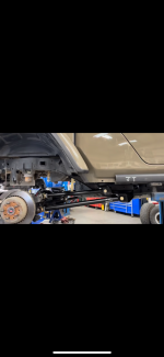

EVO released their rear long arm kit for the JT and it looks bad ass. Had some time to drop it off to have a set installed. I also had a set rocker skins put in along with having Mel cut off the lower shock mounts to relocate more outboard. Mel even took the time to place them 2 inches higher on the axle tubes. Giving me back the travel I lost after the engine swap. IMG_0890.jpeg

EVO released their rear long arm kit for the JT and it looks bad ass. Had some time to drop it off to have a set installed. I also had a set rocker skins put in along with having Mel cut off the lower shock mounts to relocate more outboard. Mel even took the time to place them 2 inches higher on the axle tubes. Giving me back the travel I lost after the engine swap. View attachment 416852
Awesome looks great!
