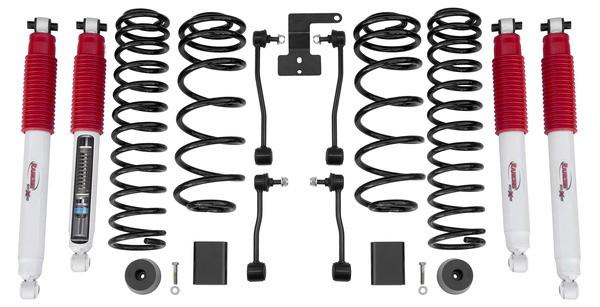

Going back to my original post, what I want/need is:
1. Smooth ride; the same or better than my current ride.
2. A leveled vehicle; I can't stand the factory rake that is on her.
3. A more aggressive (higher) stance.
4. Eventually move up to 35" tires.
Is this the right kit for what I am looking for: https://www.extremeterrain.com/ranc...ension-lift-kit-rs5000x-shocks-rs6612br5.html
I will not be getting it from ET but unfortunately they are one of the few net shops that list them and show the components.
Is there anything else I should order when I order the kit? LCA's, Geo brackets?
Thank you so much for all of the input and putting up with my crazy questions!

1. Ride quality is 100% subjective. That said, I personally found the Rancho coils to be one of the softest I have ridden on. Also, regardless of what lift kit you install, hydraulic shocks will offer a smoother daily driver ride than monotubes. It's just that simple. If you get the adjustable 9000 shocks, you can set them to however soft or firm you want them to be. Where monotubes outperform hydros is out in the desert driving hard and fast as they will not fade.
2. I personally felt that the Rancho kit offered a very level ride but would be first to admit that my opinion is subjective.
3 & 4. The Sport lift WILL be a good fit for 35's and can even clear 37's. I've done it and felt that it did it better than much more expensive kits that I've tested.
Installing drop brackets will eliminate the need for adjustable lower control arms up front. While they will give a better feel, they will also be rock targets that you just paid good money to get higher up. So, it's a toss up. What I would recommend is just install the kit as is and drive your Jeep for a bit. You'll know one way or another if a geometry correction is needed for your taste.

I think this is the best for my needs but I am just not sure: RS66124BR5?
I'm not sure if the 3.5" is too high for me. I tried to find a 2 or 2.5" sport lift and they don't seem to have any. I asked the Rancho tech service folks and this is what they told me I should use.
Unfortunately nobody seems to have them in stock. I called Rancho and tried to order it directly from them; of course I can't unless I am a vendor. They are out of stock until November 5th but have several coming in with no back orders on them yet. I have reached out to Quadratec and haven't heard back from their sales rep; it isn't a stock item for them.
Once I am sure this is what I need I will reach out to the local shop and see if they can get their hands on one.
