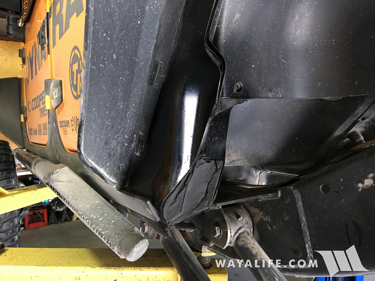

As you can see here, even though the pinch seam and a portion of the body have been trimmed, our new 40" Cooper was still making solid contact with the edge of the fender well and rubbing the paint clean.

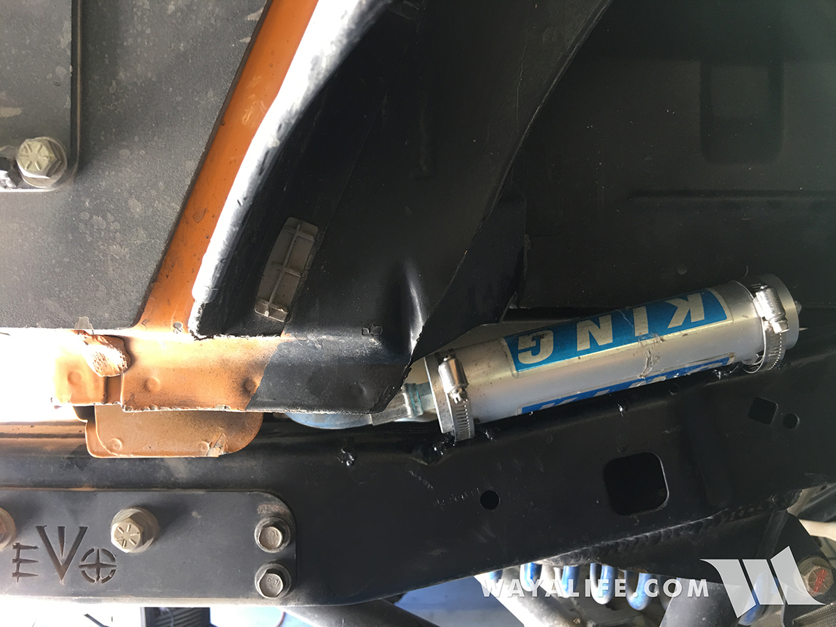

Contrary to what so many people seem to think, your rear axle travels in an arc and even though it may not "look" centered under your wheel well at ride height, your tire will travel backwards under full compression. As you can see in this pic, our new 40" Coopers were still making solid contact with the rear pinch seam as well and this in spite of the fact that a considerable amount of it had already been trimmed.

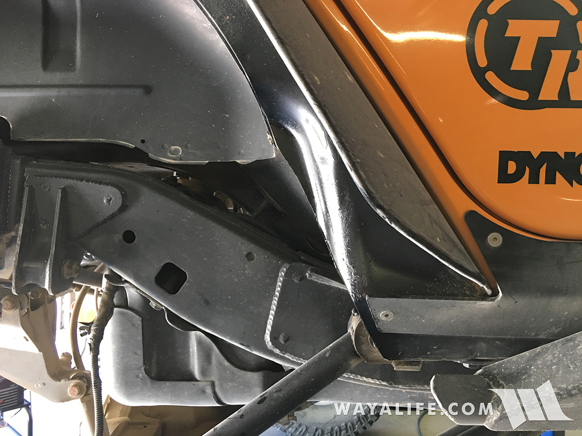

Here's a shot of what the front half of the fender well looks like after being hemmed.

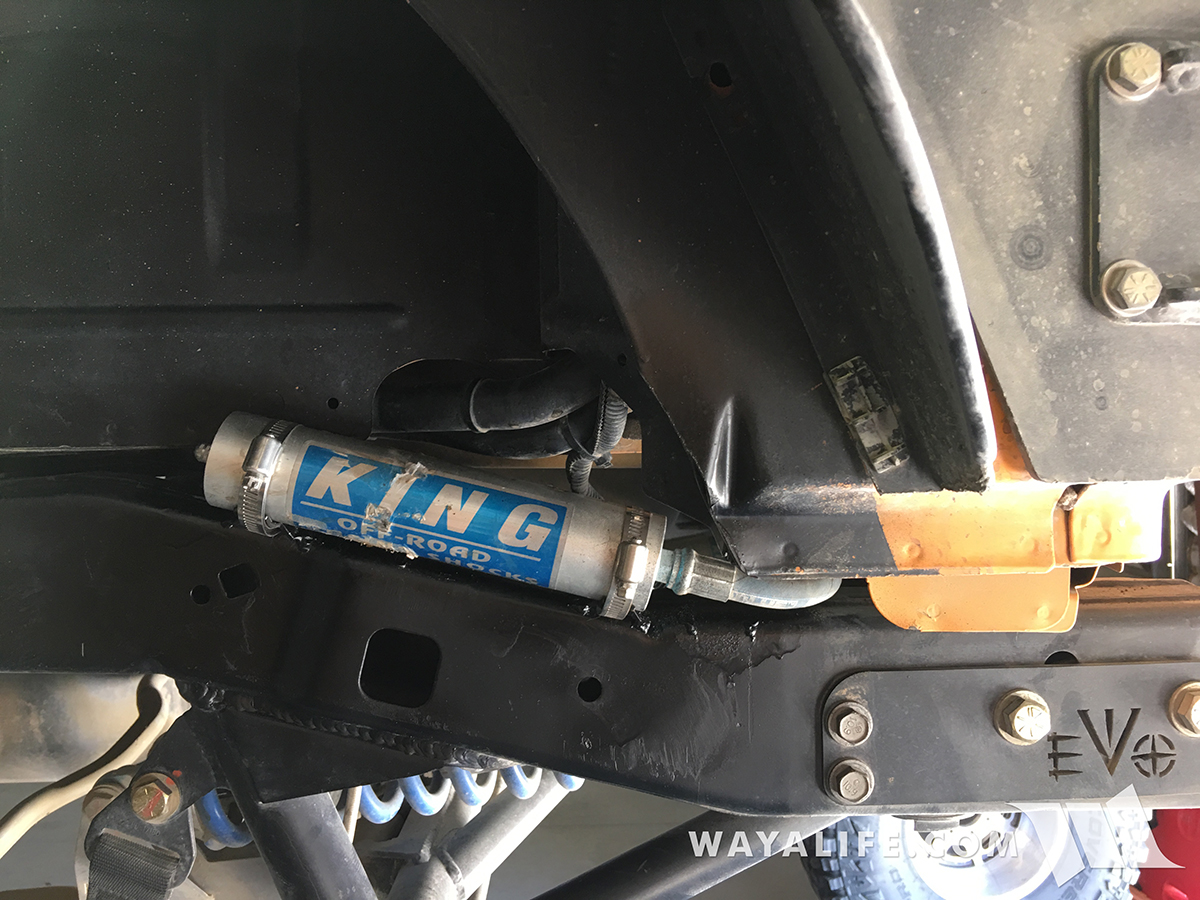

And here's a shot of the rear pinch seam.

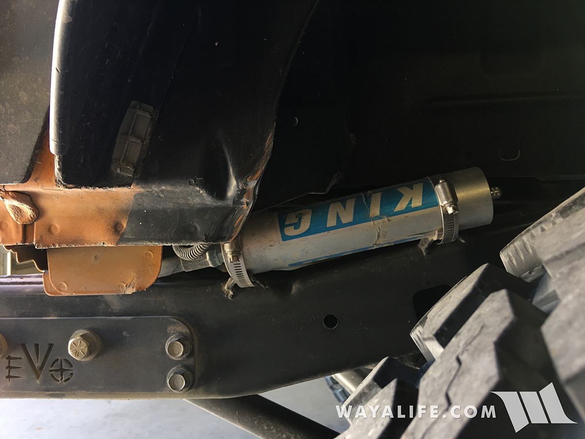

A few shots from the driver side.
