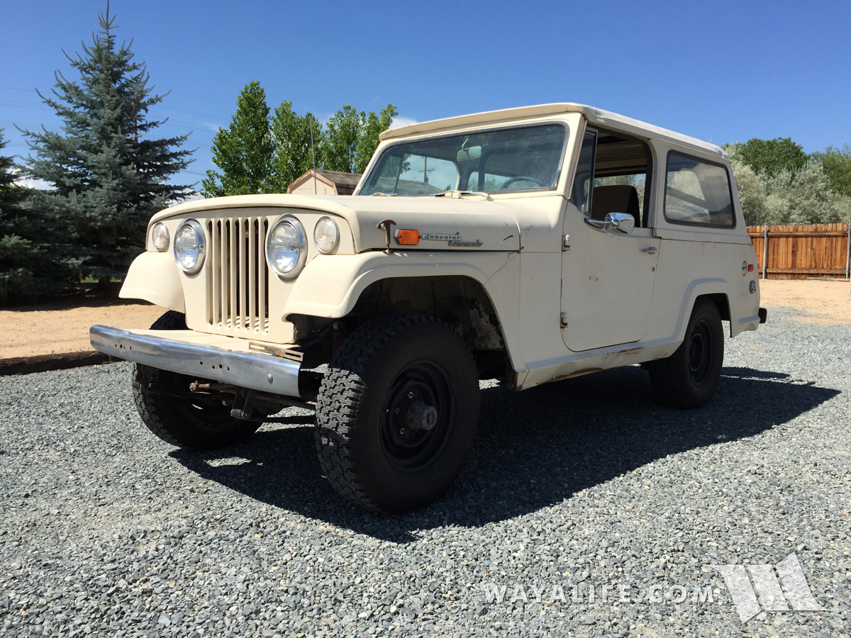

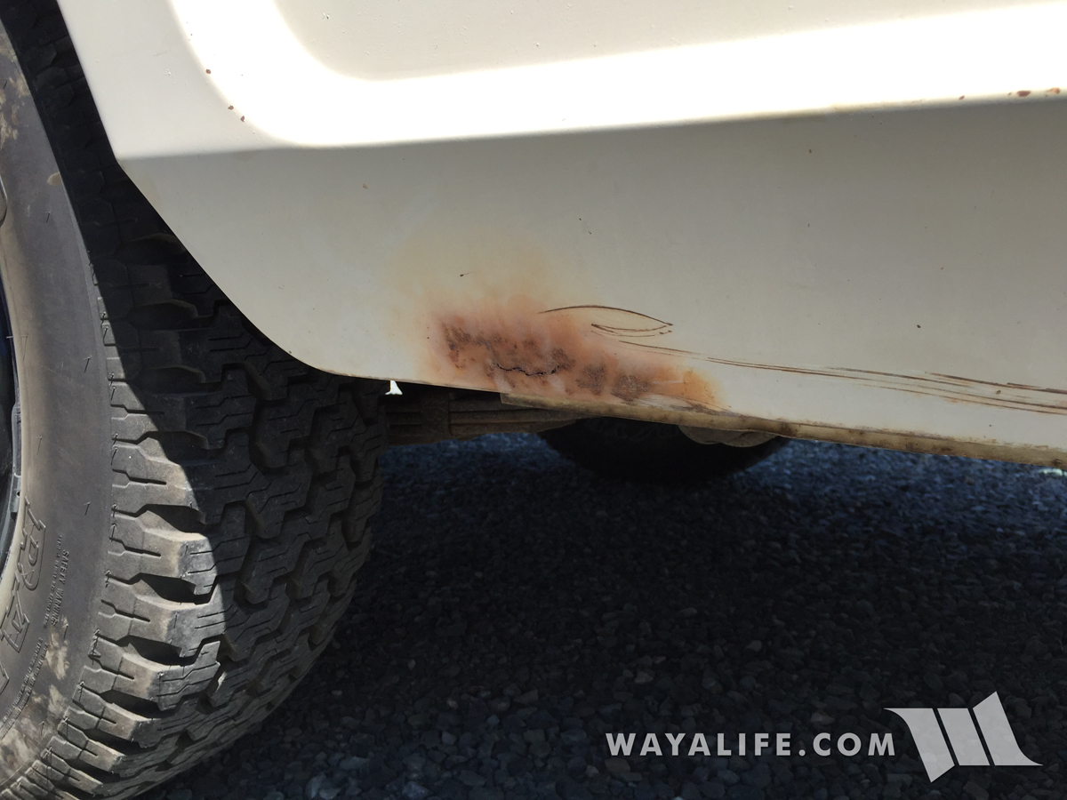

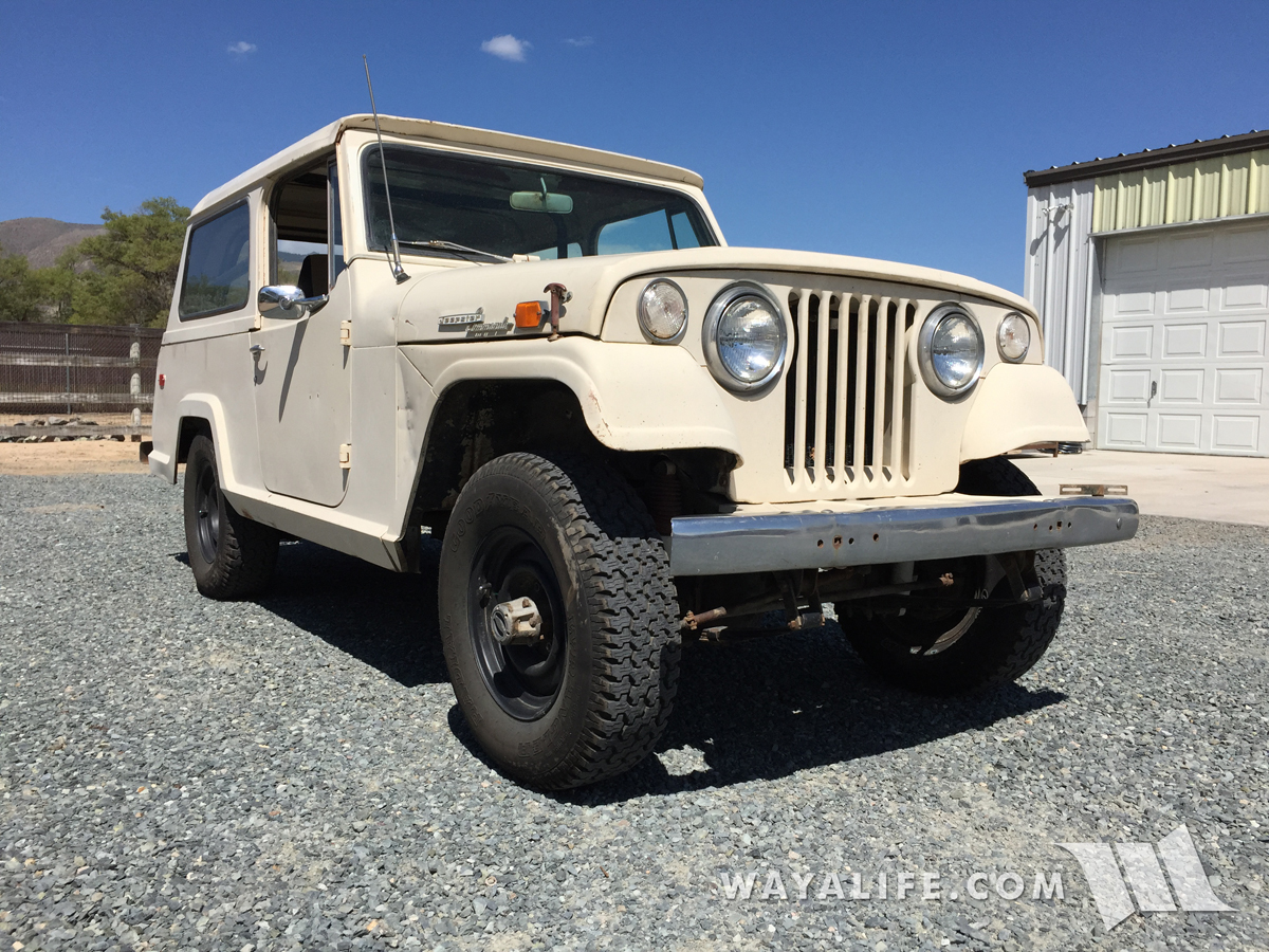

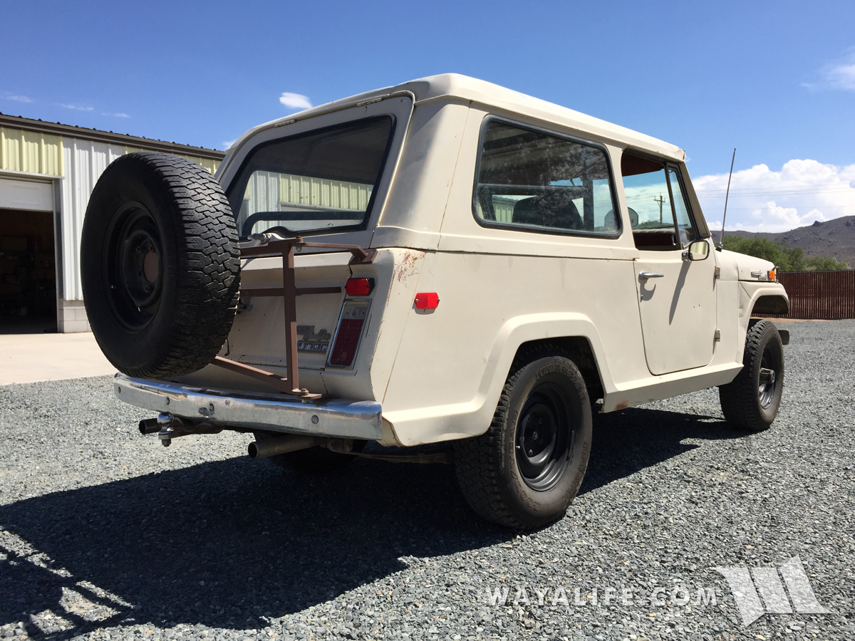

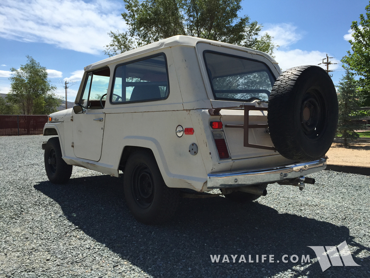

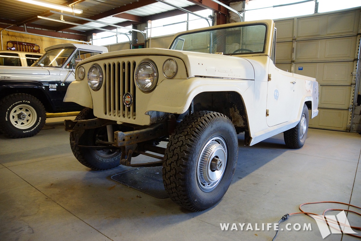

For those of you who've never seen them, here are a few pics of what Emma looked like when we first brought her home.

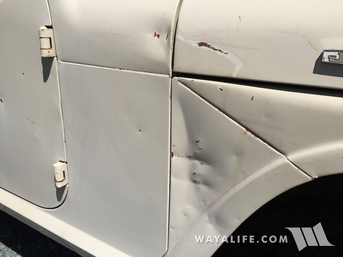

With the exception of her weathered paint, miscellaneous holes, signs of cancer and beat up front fender, she really didn't look too bad on the passenger side.

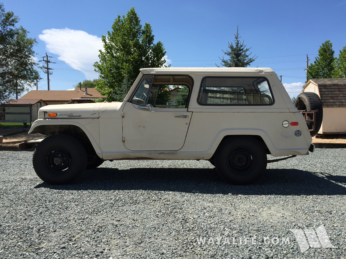

A rear tire carrier may seem like a nice thing to have but it totally robbed Emma of her unique fast back design and it had to go.

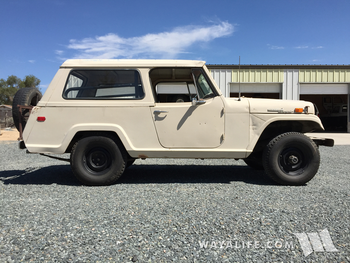

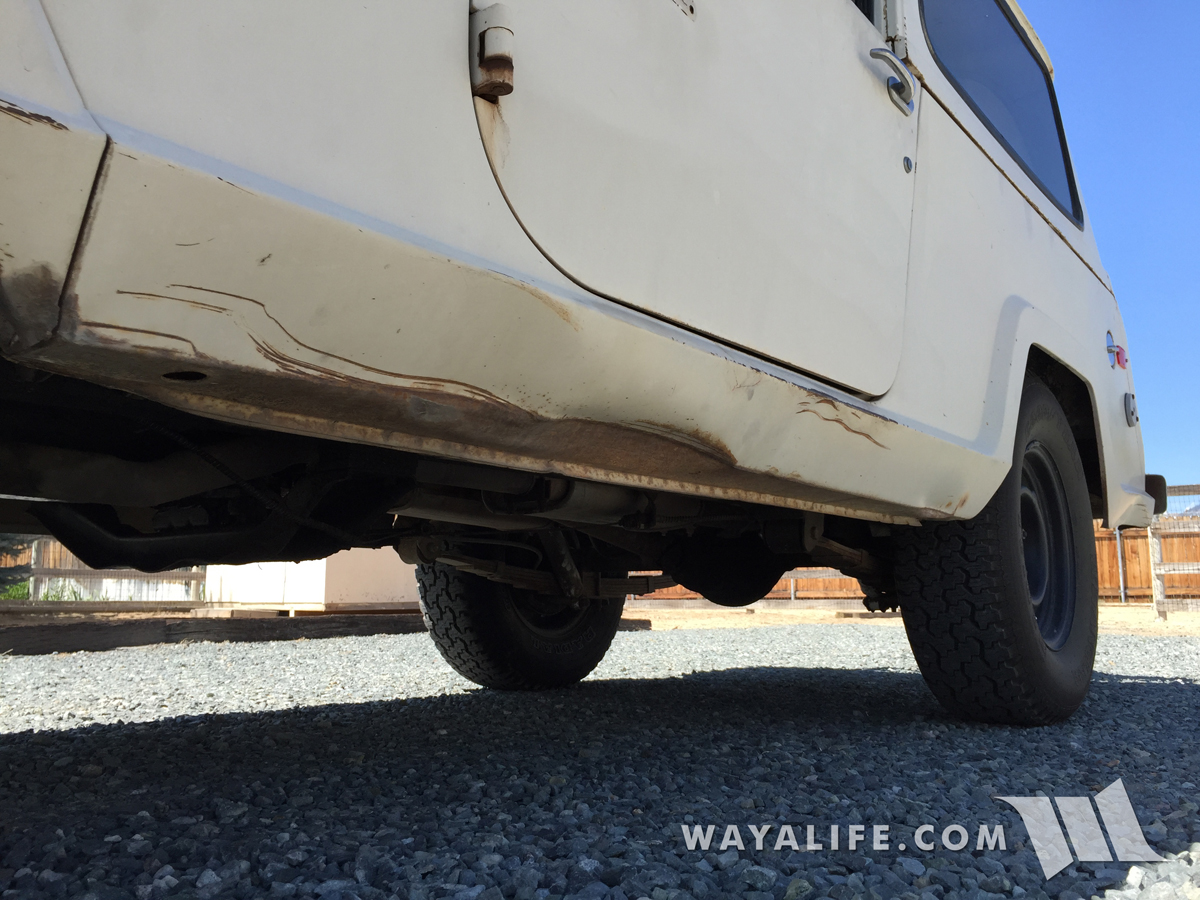

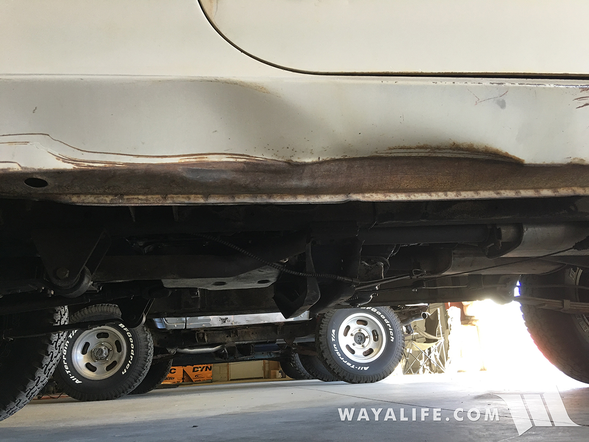

The driver side is where her biggest problem and that was her crushed in rocker panel.

Initially, I was thinking I'd be fine just cleaning Emma up a bit and using her as is - a tired old Jeepster but once I got fixing a few of her dents, I really wanted to fix more. Of course, the one that was really bugging me was her driver side rocker panel especially being that it was so crushed in and before I knew it, I was on a mission.

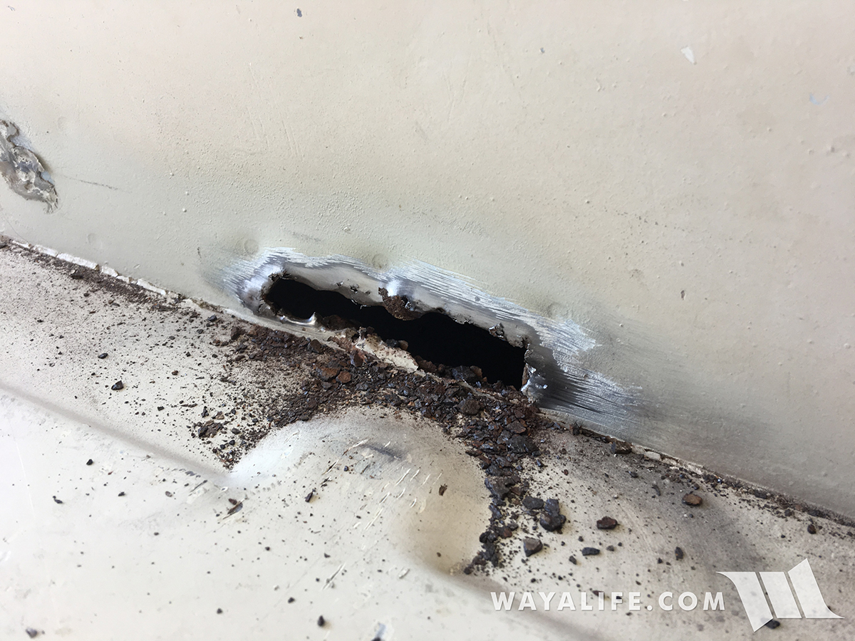

Using a body hammer to tap at a pair of blisters on the base of Emma's rear fenders, it became pretty clear that there was some cancer lying just below the surface. Sanding the paint away proved as much.
The only real way to kill the cancer is to knock it all out and keep knocking until you've reached solid metal again.
After making sure that I cleared out all the rust, it was time to patch the hole. You'll have to forgive my shitty welds. Even with the tire removed, I had a hell of a time getting in under the fender to see what I was doing.
