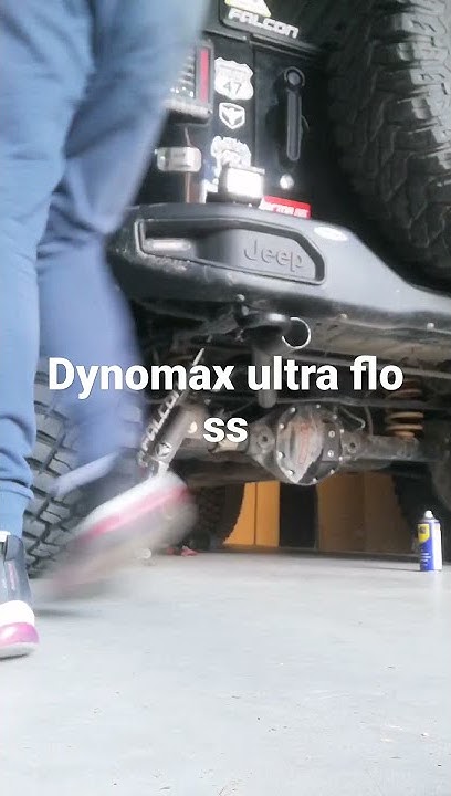

Dynomax Ultra Flo SS exhaust system

No. At 70mph with Cruise on it's worse than before. At low Speed i feel sort of vibration from the engine. The only thing i've forgot to seal each parts.

If you have leaks in your exhaust, it will not work as intended.

Hi After long period finally i've sealed al the tubes with an exhaust paste. The problem Is less than before but i still feeling a strange throttle response. It seems engulfed.
