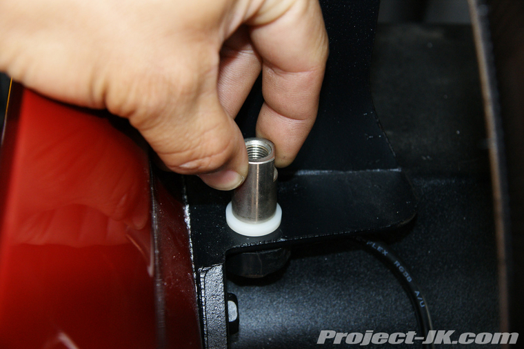

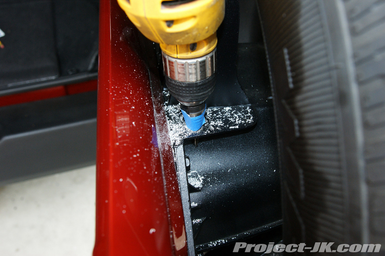

Depending on how much room you have to work with behind your spare, you could drill into your tire carrier and just use it for a mount. I had done tried this a long time ago on my old 2009 JKU and it worked pretty good. You will need a coax cable with a flat terminating end like this though.
All you have to do is drill your hole here making sure that it'll fit the diameter of the of the stepped nylon bushing.
And then attach your mounting stud to it.

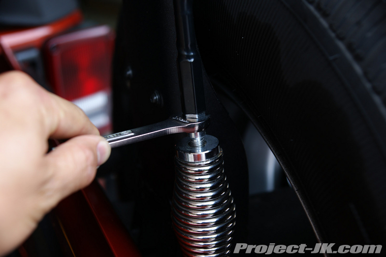

I prefer to use springs with my mounts to help absorb hits but otherwise, you just need to connect your antenna from there and go.
