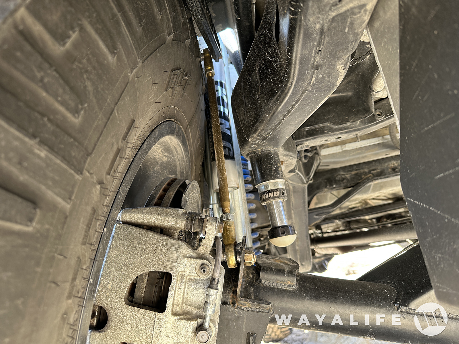

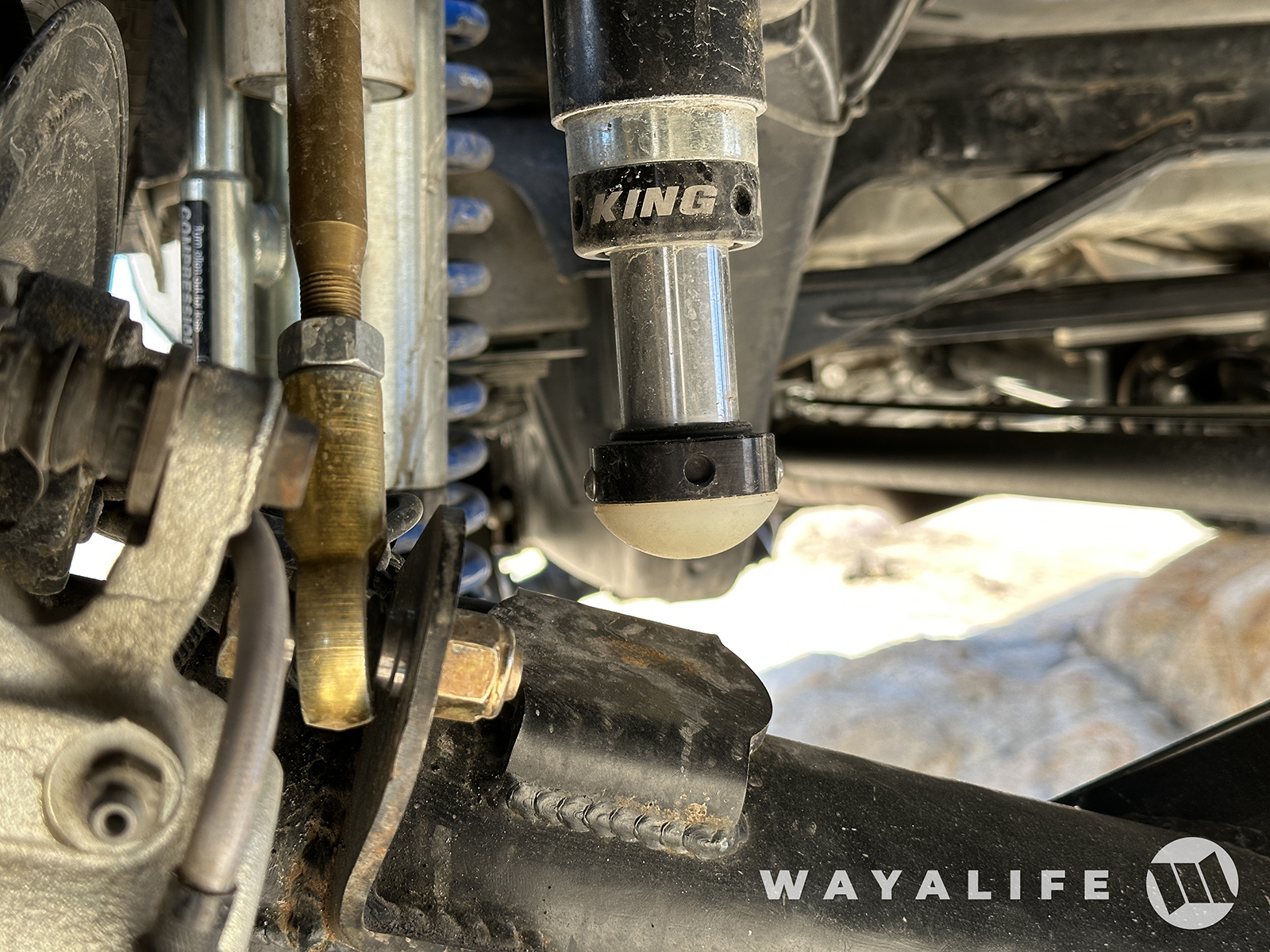

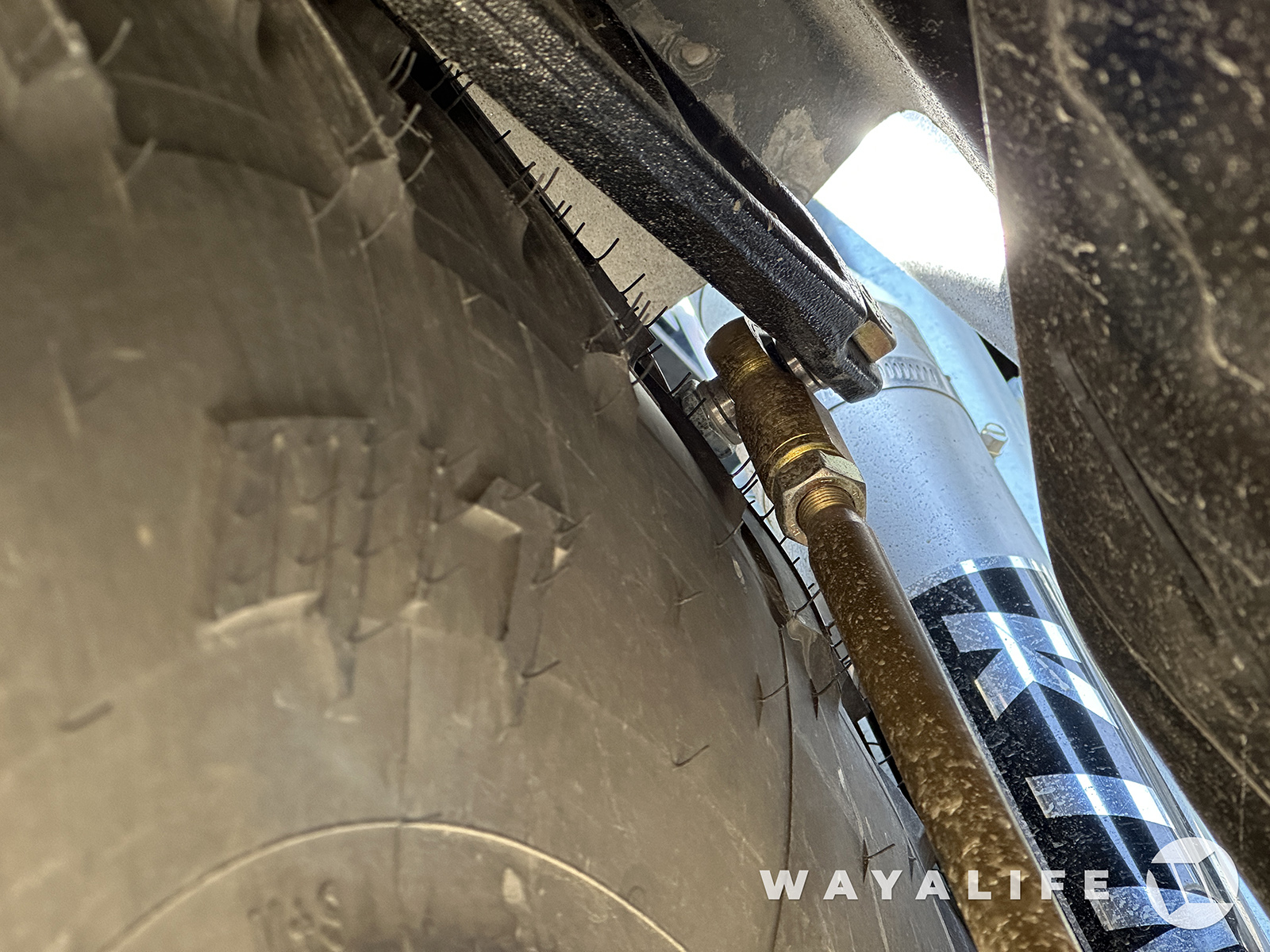

I should note that we are still working through some of the challenges that come with really big vertical travel and the first thing we noticed is that our rear axle isn't centered. And, at a full flex, the driver side rear tire is rubbing against the rear sway bar end link bolt and the tubes on our bypass shock.

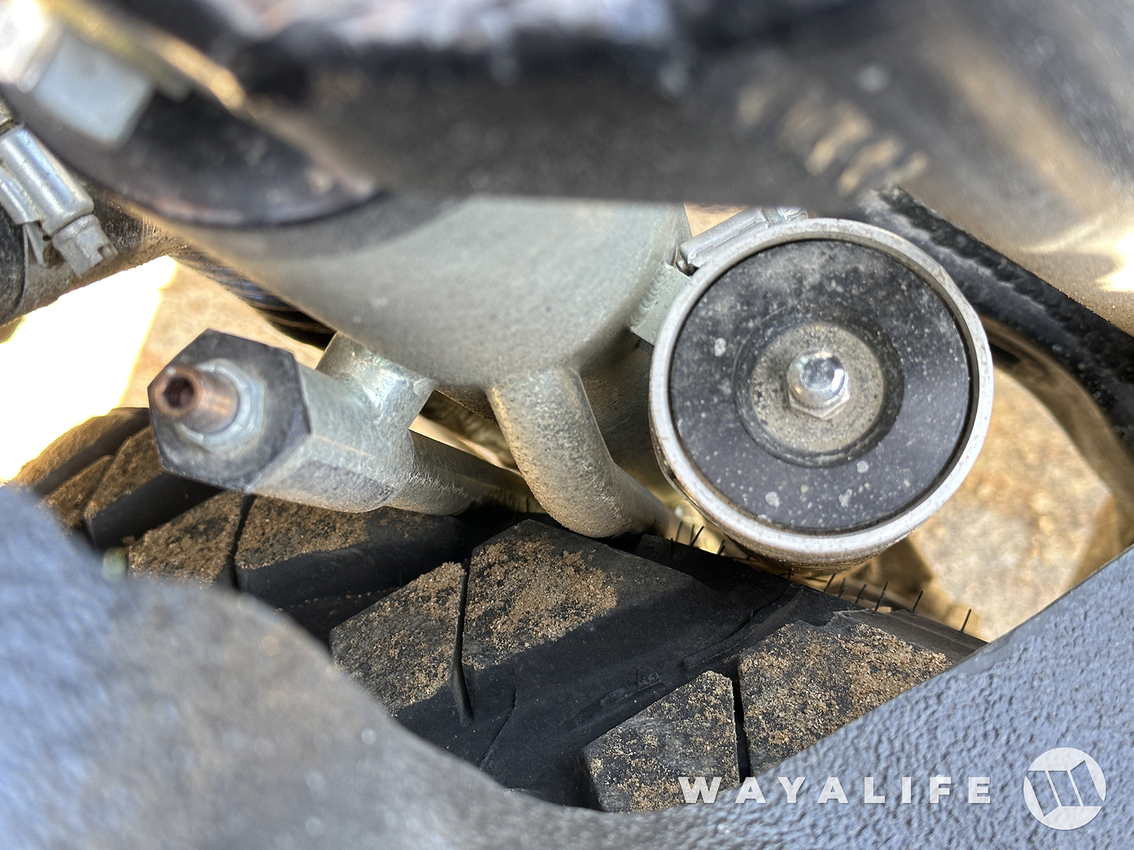

A big benefit of the heavy duty 28 spline torsion bar that we installed with the Antirock is that it offers enough resistance to prevent full bump from occurring when flexing. This prevents the arm from making contact with the fender and prevents the tire from tearing off the fender. As you can see here, the air bump is still far from the axle even with the opposite side tire lifting off the ground.
Of course, this is still a problem we'll have to address when bombing across big whoops and so, we've got more figuring out to do.

To be clear, the JK arms only fix the problem of full droop. Articulated full stuff looks like it won't be a problem either due to the heavy torsion bar rate. However, full vertical bump "may" still be an issue as the sway bar arms will still smash through the fenders before the air bump are fully collapsed.

Thanks! Been a work in progress for sure. Being that the upper arms are triangulated, centering the axle may take a bit of work. Unfortunately, you cannot make adjustments on the rig and removing the arms is a bit of a pain. And then, there's the issue of pinion angle and maintaining it.
