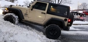

Through January and February the Jeep definitely got to have some nice and snowy adventures! From some good drives to work in the snow and finding the unplowed roads, to climbing snow piles in parking lots, to some up north drives that the pictures don't do them justice, but blind snowfall in 15-20 MPH winds on back country roads and most of the time, no tracks! The Jeep definitely got me everywhere I needed it too! And I had fun doing it!

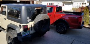

The Jeep also ended up getting a new sibling in March! I ordered a new 2019 Ford ranger back in December, and come March, it was finally ready to be picked up! the Ranger was meant to be the new daily driver so I could have even more fun with the Jeep! The new Ranger is an XLT with the FX4 Package in Hot Pepper Red! Definitely feel lucky to have such great choices to pick from when i gotta grab a vehicle and go drive some where! Here's a few shots of the siblings together!

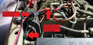

Next up was looking into maintaining the Jeep nicely when it is not getting driven every day since it was no longer the daily driver! I wanted to get a battery tender and looked through a lot of options and reviews and decided on the Optima Batteries Digital 400 charger. now I paid a bit more for this charger than a lot, but it has a nice interface, and I do feel in some cases, you get what you pay for, and for my peace of mind, this i felt was a good all around option for me!
The charger worked great right from the start, and was very easy and simple to figure out! I started by using the clips for the battery, but i found those to be hit or miss, and with out much I would be taking the cables on and off, I decided that the best route was to use the included hard wire kit. And this was another point for me purchasing this kit! The kit came with leads that you permanently install on the battery, and there is around a 2-3 foot length of cable with a nice plug with a cap. This then plugs into the long cables on the on the charger itself, and you are good to go! And when you want to drive the Jeep, you just unplug the wire and tuck the end away in the engine compartment of the Jeep, and the cap protects the leads very nicely!
Overall, I have been using it for 5 months at this point, and it has been working great! No complaints!
