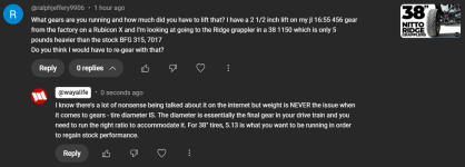

I honestly don't know who all the internet experts are that are pimping such really really bad information when it comes to gears and tires but holy hell, they are out there in force! On a regular basis, I get comments like the following that was posted up on our YouTube channel...
So that it's clear, when it comes to gears, tire DIAMETER is the ONLY thing that matters as it is in effect, the final gear in your drive train. Tire weight NEVER matters or at least, when it comes to restoring lost power when running a larger size.
