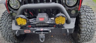

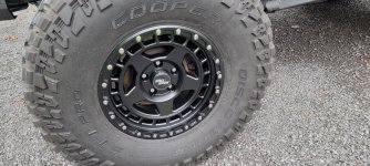

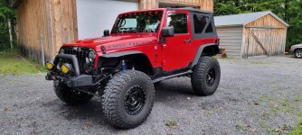

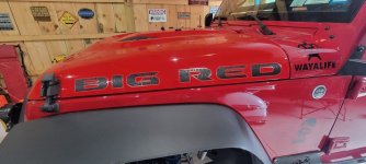

I was recently lucky enough to purchase Steve's old JK "Knuckles." Last week I reached out to the guy I bought him from to see if he had any contact information on the original owner and fortunately he had kept Steve's info. Steve was kind enough to share his build thread on this sight so I had some background on this beautiful build. Without knowledge of his history, "Knuckles" has now been rebadged as "Big Red" but I'm sure his personality will remain the same! A few things have changed. I replaced the beadlocks due to the fact I couldn't get them balanced well for highway speeds. The new wheels are a set of RockTrix that now roll smoothly. I also replaced the track bar with a Rough Country bar to eliminate the death wobble he would sometimes get when hitting sharp bumps (all good now). Other additions are an ARB stubby bumper, a Warn VR8 Evo S winch and a pair of Baja Design LP9 knockoff fog lamps (ridiculously bright...I can't believe the originals could be any brighter).
