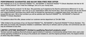

Issue with Rancho warranty/Guarantees?
I’m glad I could provide some food for thought today! Lol. It’s somewhat comforting to see that Sharkey agrees with me. It’s an interesting dilemma, but either way I’ll be sure to post back here as soon as I hear something. I Know Matt is busy in Moab but I hope he finds the time to respond to me soon. The waiting game will make me anxious [emoji23]

Happy to say I can finally reply here with an update. I won’t go into any details out of respect for Rancho but I will say we have worked out a solution that I am very pleased with. Very stand-up company and I appreciate their willingness to work with me. Thanks a lot guys [emoji16]
