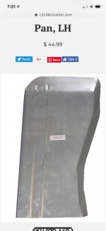

Ordered my pans, hopefully have them thursday and I can spend the night getting them welded in. Then to really decide what to do with this heap.

Test fit last night, need to decide how much more I want to trim and how exactly I want to weld it in. Fits perfect tho other than being a little short. Not like I can’t fan up that small piece tho. I am half tempted to also get the 4 link brackets installed before I get the floors patched just Incase I can better reinforce how those mount to the “frame rails”

That's what I would do. A lot more comfortable position to weld it would appear too.
