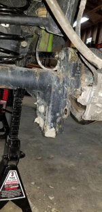

I just Took delivery of some fusion 4 x 4 axles which are Dana 60 and order new rockstar skids. It looks as though the bracket tree works without the skids, should I have any concerns not using the Evo brackets?

The purpose of the Rockstar skids is to get you better ground clearance. They aren't required if you don't have that concern.

I was thinking they had some sort of geometry correction for the coilovers as well? Not true?
The geometry of the bracket looks a little different but I think its because the mounting holes are more in the back instead of off to the side also by moving the bracket up puts the shock at a slightly different angle. But as far as I know its unrelated to the coil overs

Sway bar link should be on the inside of the rockstar... :thumb:

The lower shock bolt should be turned around. If you wheel much with the net and threads inside, they will be near impossible to get off later on.
Plus the bolt head don't stick out as far to grab like an anchor.
