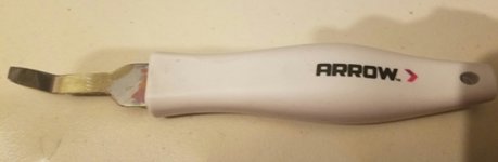

an offset screwdriver will work if you have one (can't believe I couldn't find one offset at the proper angle) or this Arrow staple gun staple remover that I found for $4 and modified:
original as purchased:
modified to fit the opening in back of the steering wheel and to get under the spring lock - had to narrow the sides 5/16" width and down 1" from the bend and square the tip to get it to fit the openings and slide under the clip
