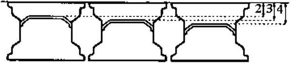

The wheels look like XD840 Spy II. If so, the 17x8 come with a 5.21 inch backspacing while the 17x9 are 4.53. If you are getting the rub at full turn, you most likely have the 17x8.
