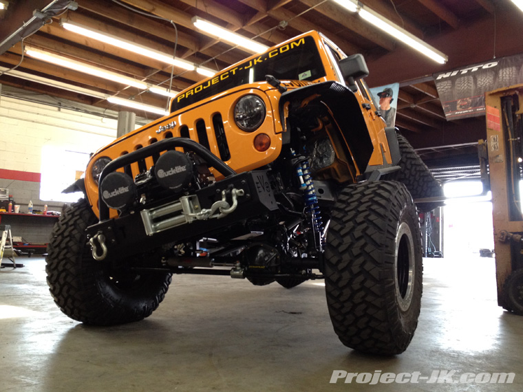

Well, I know you didn't ask me and this is just with 37's on factory Dana 44's but, here are some shots of the EVO bolt on kit fully flexed.
If you ran the evo bolt on coil over kit with 14" shocks would you be closer to the dtd travel?
Kit comes with 12" shocks.
well, i know you didn't ask me and this is just with 37's on factory dana 44's but, here are some shots of the evo bolt on kit fully flexed.
I know, i was just asking if i chose to run that kit would it change much if i decided to run 14" instead of the 12" that it comes with?
Let me rephrase that, evo bolt on coil over kit is designed around 12" shocks. 14" shocks probably won't fit.
