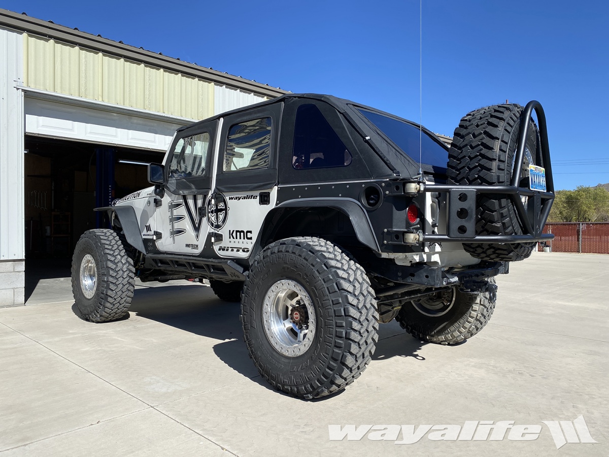

10/25/20: Got more work done on Moby yesterday and getting a little closer to being ready for the 10th Annual JKX or should I say, the all new "Dirt Experience". First and foremost, Moby is now wearing new decals highlighting the sponsors of the Dirt Experience as well as a windshield banner for it. Also, we finally got around to installing a set of KC 4" LZR A-Pillar lights to replace the big Truck-Lite driving lights that we used to have in front of the grill. Sure, there are bigger and better lights we could have installed but these are what we could get in a pinch and we really like the fact that they're small and blend into the windshield, this as opposed to sticking out like sore thumbs. Also, from our initial test of them, we found that they put out a good volume of light and do a great job of distributing it evenly and without hot spots. Anyway, here are some pics of what Moby looks like now.
