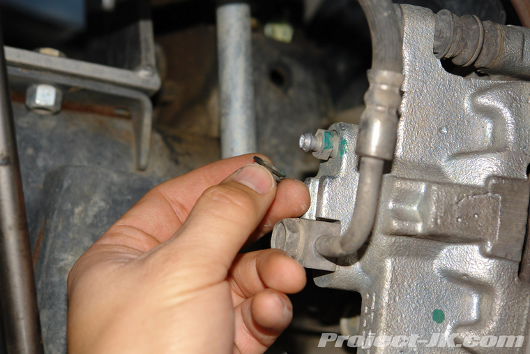

3. Remove the rubber cap attached to the brake caliper bleeder valve as shown in this pic.
4. Place your 11mm wrench on the brake caliper bleeder valve/nipple and then insert the tapered fitting into it as shown in this pic (or over the nipple if you have a hose that will fit it). Attach the jar using the magnetic head anywhere below the nipple.

I like to put the box end of the wrench on the bleeder instead of the open end and then slip the rubber tubing on the nipple.
The flats for the wrench on brake bleeders strip so easy I think they make then out of bubble gum.

On my write-up, I show the open end of the wrench being used on the bleeder valve as, at the time, it was easier to hold with my left hand an shoot with my right. However, if you use the closed end, it'll help ensure you won't round it off.
