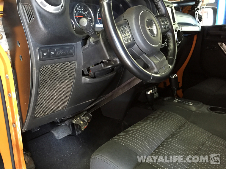

1. If you have a 2007-10 Jeep JK Wrangler, turn your steering wheel until it locks in place. You will need to have your key out of the ignition to make this work. If you have a 2011-up, hook a ratchet strap around the base of your steering wheel and secure it to the brake pedal as shown.

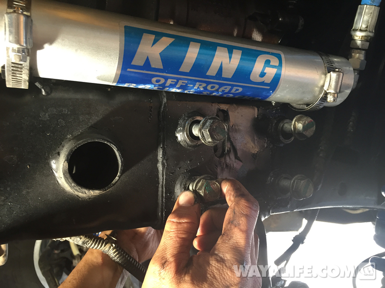

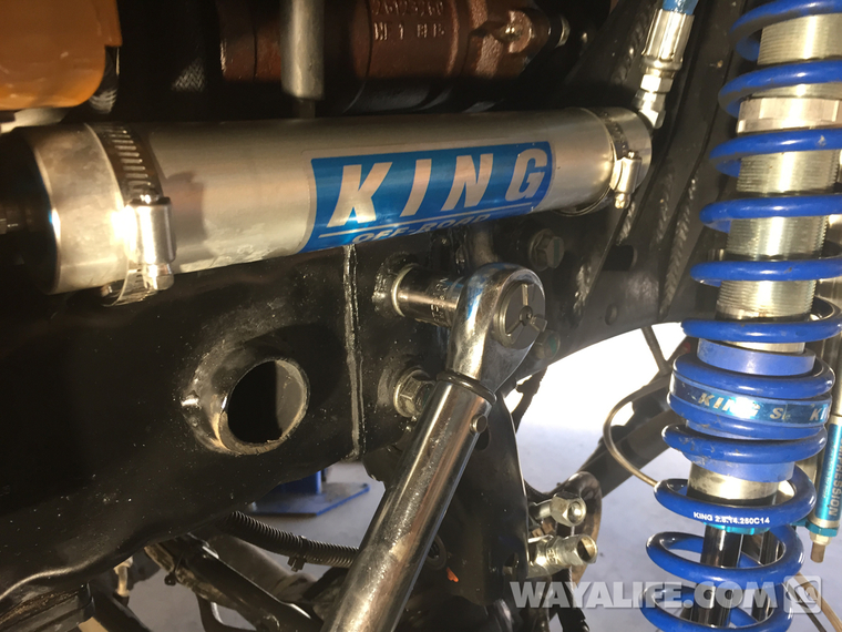

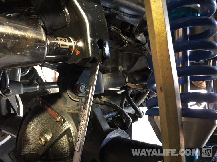

2. Use a 21mm socket and wrench to remove the front track bar bolt and nut from the frame.

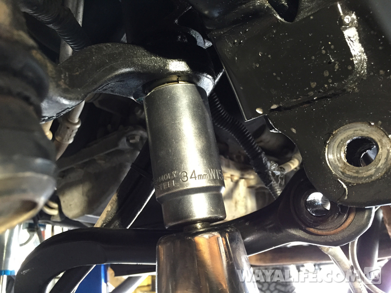

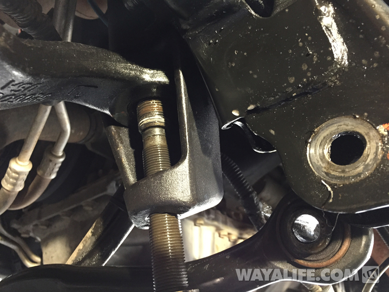

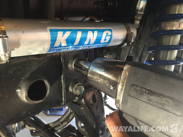

3. Use a 34mm socket to remove the pitman arm nut. An impact wrench or breaker bar will be needed to remove the nut.
4. Use a pitman arm puller to remove the pitman arm from the steering box sector shaft.

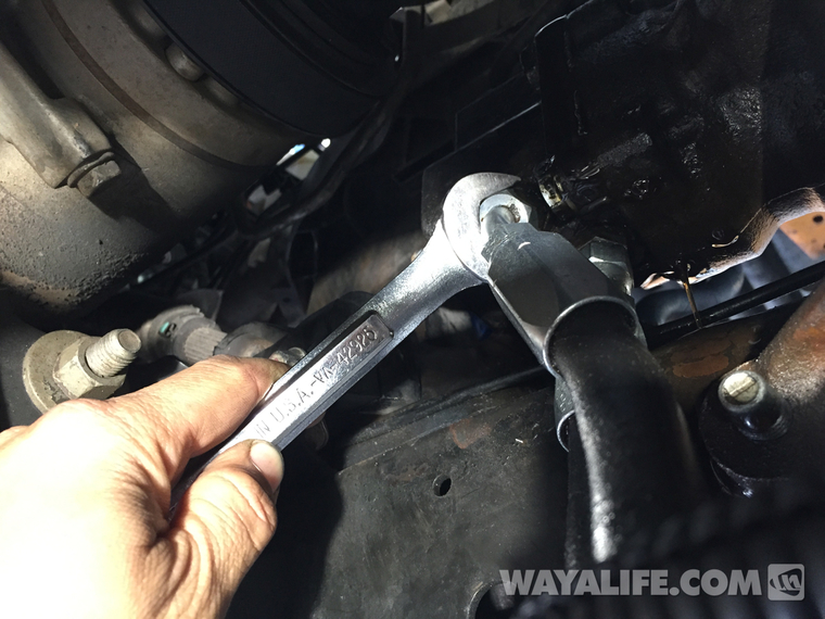

6. If your steering box has been ported for a PSC Ram Assist, use an 18mm wrench to disconnect the two hydraulic hoses from the bottom as shown. Make sure you have an oil catch pan in place as power steering fluid will come pouring out.

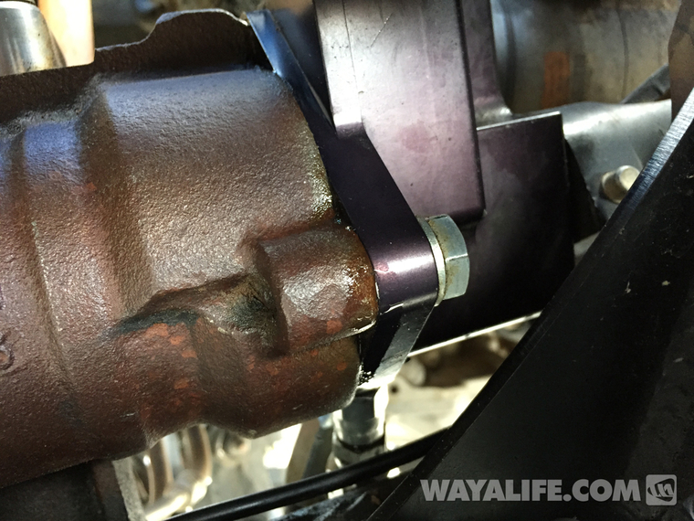

7. Using an 18mm socket, remove the 2 upper and 1 rear lower bolts securing your steering box to the frame of your JK. Loosen but do not remove the remaining bottom and forward most bolt.

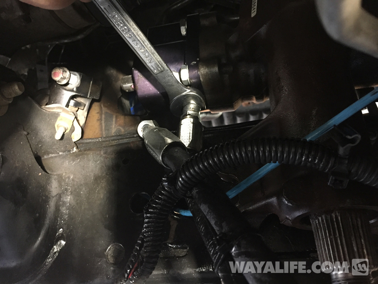

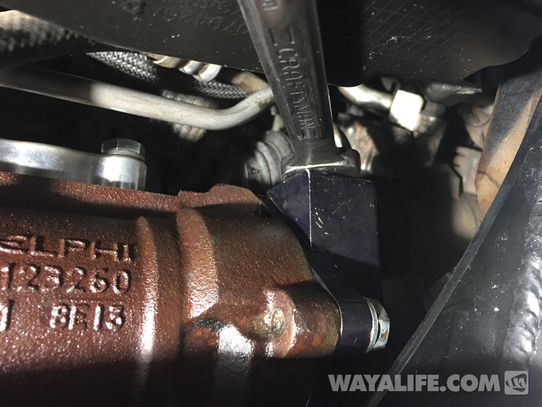

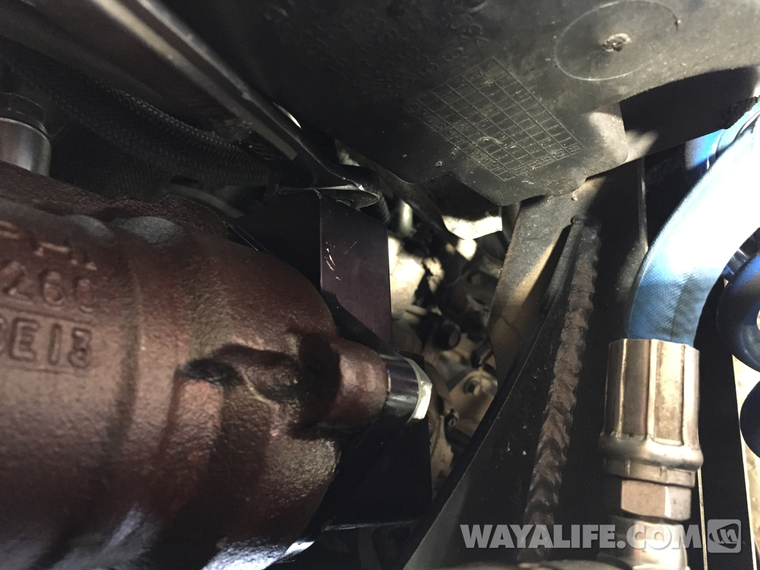

8. With 3 of the steering box bolts removed and the last one loosened, you should be able to wiggle downward and out enough to give you plenty of room to remove the 2 hard lines connected to the top of the box. You will need an 18mm wrench for this job.

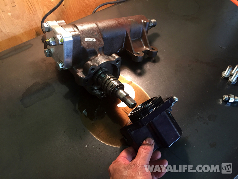

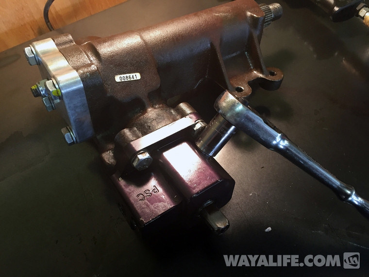

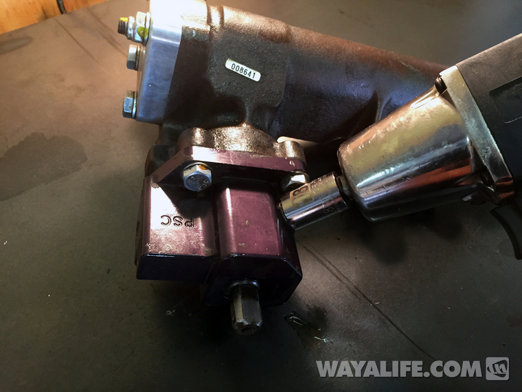

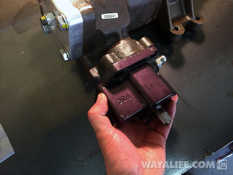

10. Use a 17mm socket to remove the 3 bolts securing the snout to the steering box.
11. With the bolts removed, carefully pull on the snout until it separates from the steering box. Be sure to have some paper towels or a rag handy as power steering fluid will come pouring out.

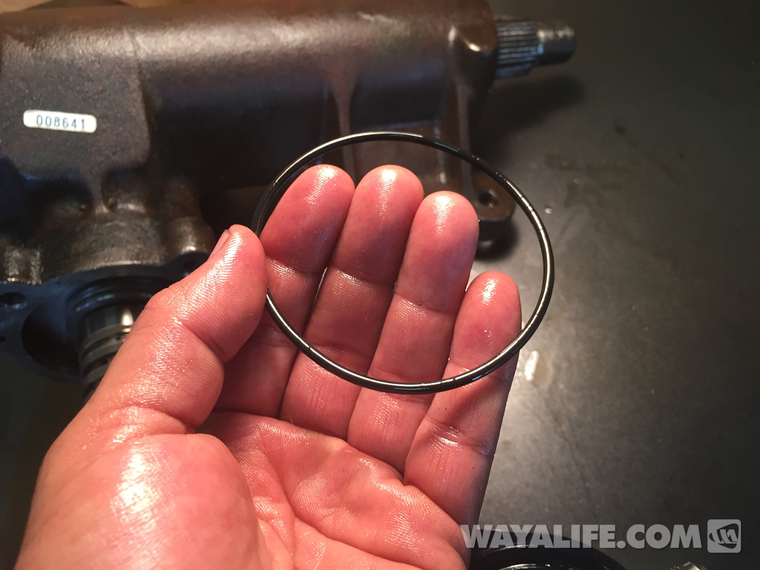

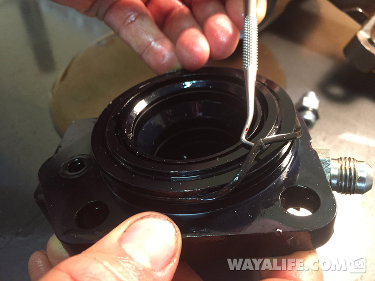

12. Using a dental pick or something similar, carefully hook and remove the o-ring off the snout. Make sure that you DO NOT scratch the surface of the snout.
13. Apply a thin coat of petroleum jelly or grease to the new O-Ring and install it on to the PSC snout.
14. Carefully push the PSC snout back on to the steering box until the mating surfaces are flush together again. Be mindful of the new o-ring as you do not want to pinch or damage it in the process.

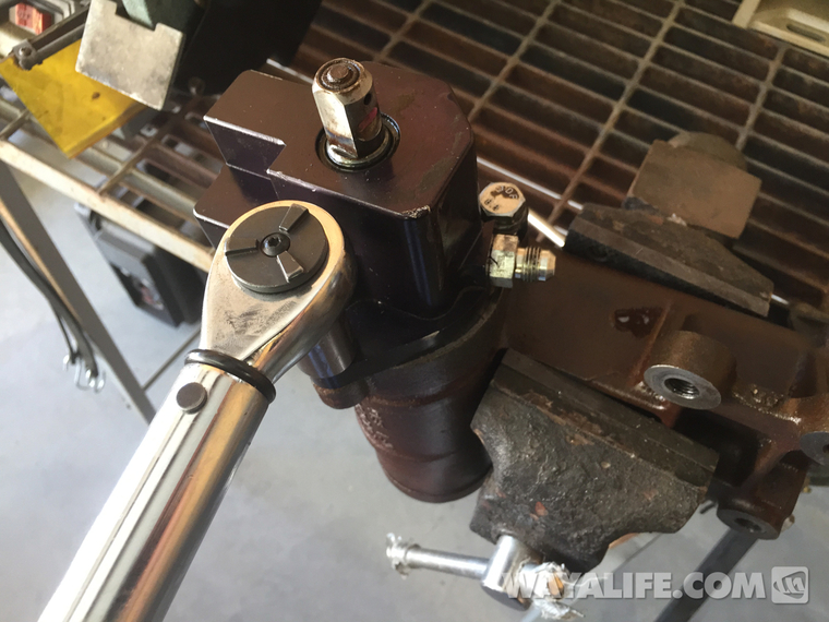

15. Put a dab of red lock-tite on the threads of the 3 snout bolts.
16. Using a torque wrench, secure the snout in place by tightening the 3 bolts to 60-65 ft. lbs. of torque.

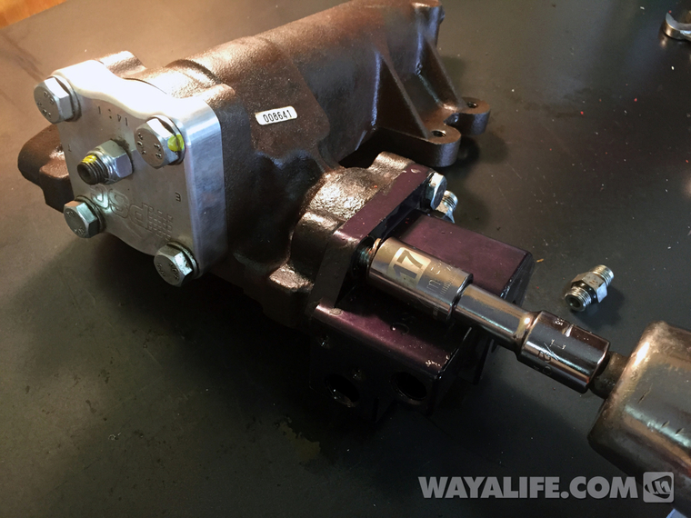

17. Reinstall the hose connector onto the snout. Tighten this bolt to 27 ft. lbs. of torque.

19. Secure the steering box back onto the frame of your JK by loosely threading in the bolts as shown.

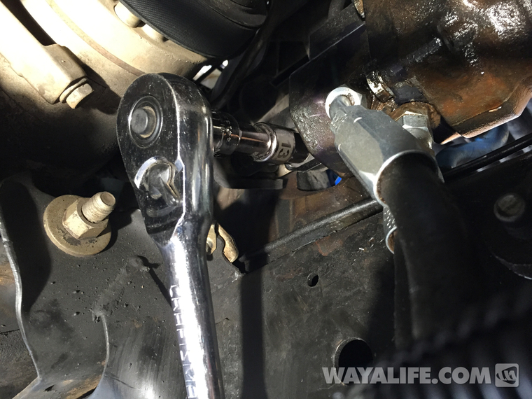

20. Use an 18mm wrench to reconnect the 2 hard lines on to the top of the steering box.

22. Use an 18mm wrench to reconnect the 2 hydraulic lines to the bottom of the steering box.

25. Remove the ratchet strap from your steering wheel and then have someone rotate it until you can line up the track bar bushing to the mounting hole on the frame. Reinstall the nut and bolt and tighten it to 125 ft. lbs. of torque using a 21 socket and wrench.
