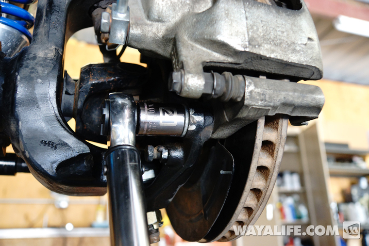

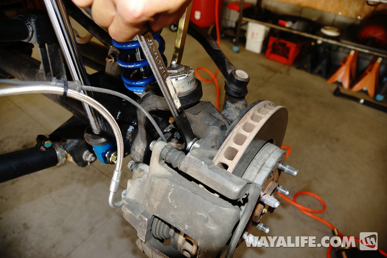

2. Using a 21mm socket, remove the 2 bolts securing the brake caliper to the knuckle. These bolts will have been installed with Lock-Tite and so you may need to use a breaker bar to get them started. This is where the lower bolt is located.
And this is where the upper bolt is. The space here is tight and you may find it easier to use a 21mm box wrench for this job.

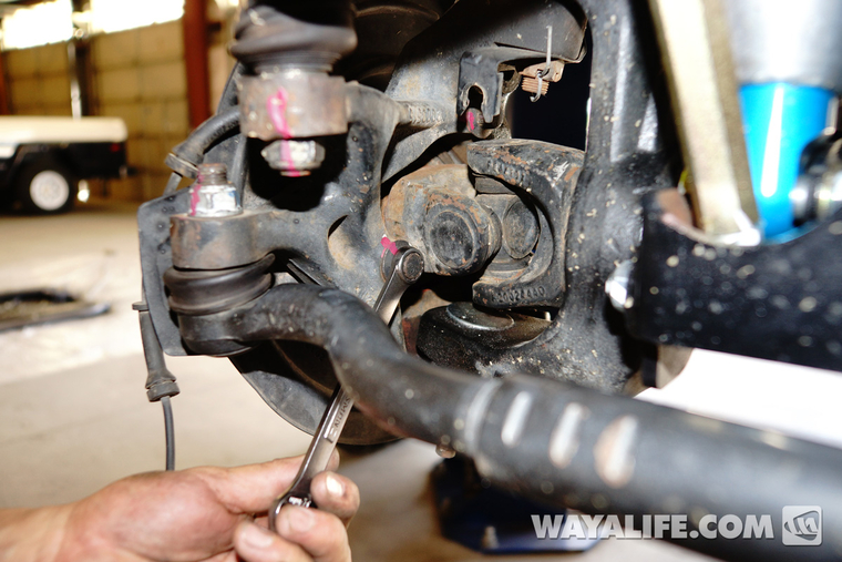

3. Remove the speed sensors from the 2 retaining clips mounted on the knuckle as shown. The rubber fittings are just wedged in place and you will just need to push down on them.

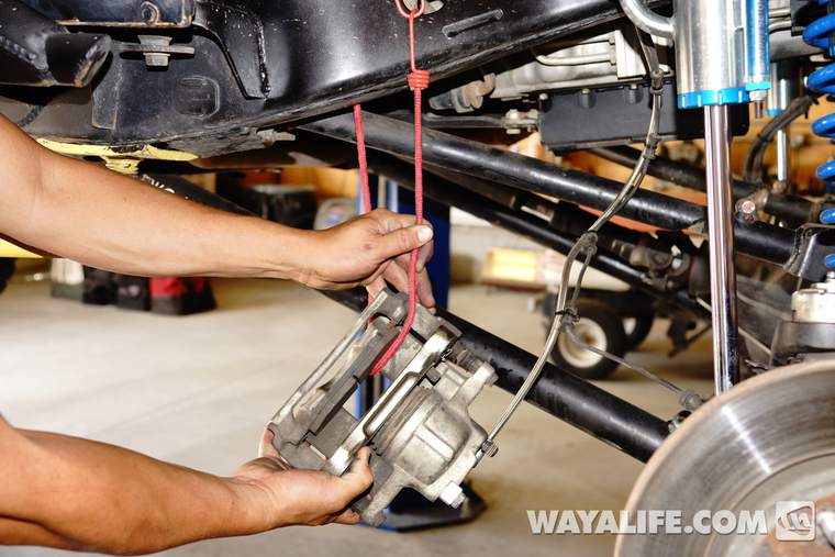

4. Use a bungie cord or zip ties to hang your brake caliper from the frame. You do not want to let the caliper dangle from it's brake line. Also, try to be mindful of not letting the brake pads fall out of the caliper.

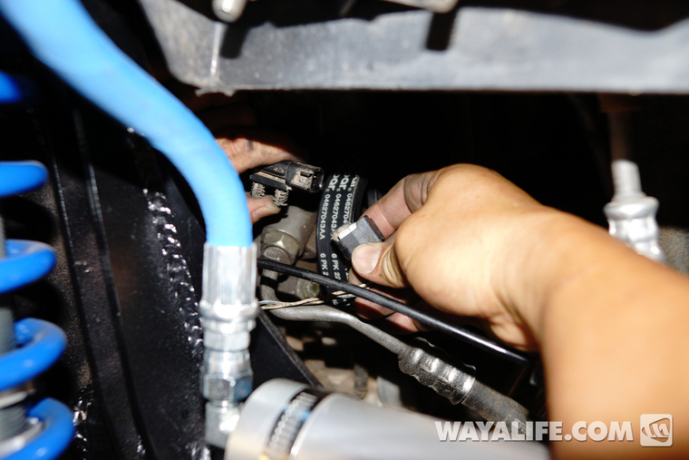

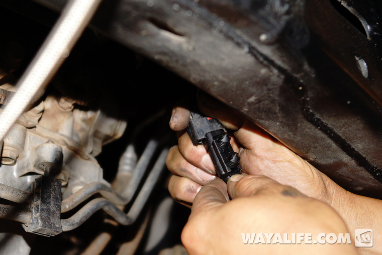

5. If you look behind the frame rail near your coil and shock tower, you will find the speed sensor wiring harness plug. Slide the red lock tab out and and disconnect the plug.

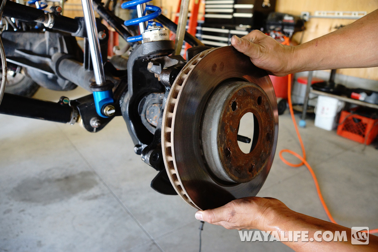

6. Remove your brake rotor. If this is your first time doing this, you may find a couple of assembly washers attached to the wheel studs holding it in place. If this is the case, use a pair of needle nose pliers to pry them off. You will not need to reuse these so you can just throw them away.

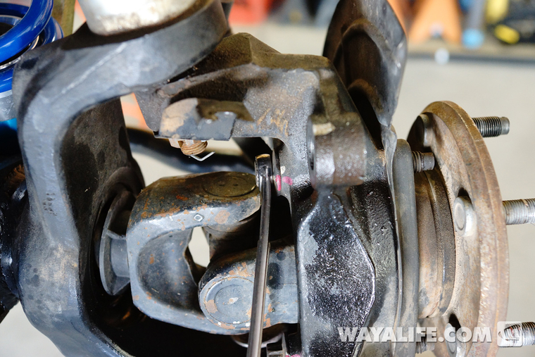

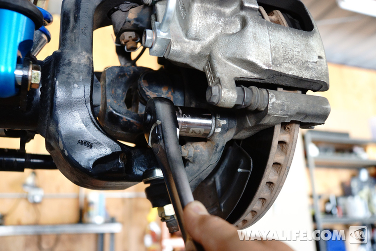

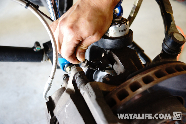

8. Using a 12-point socket or box wrench, remove the 3 bolts securing the unit bearing to the knuckle. 2 of the bolts can be found on the back.
And, there is one on the front as shown.

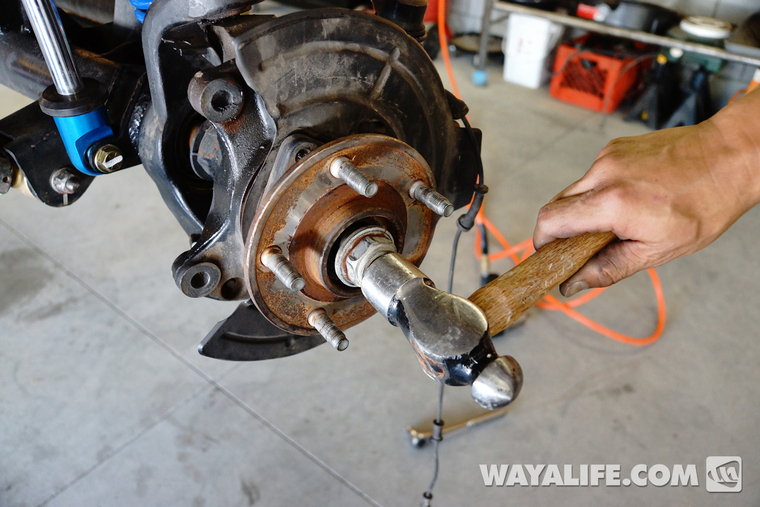

9. Loosely reinstall the axle hub nut onto the stub shaft and then give then give it a light tap with a heavy ballpeen hammer. This should be enough to free your unit bearing from the splines of the stub shaft. If you live in the rust belt of America, you may find it necessary to use a puller to separate them.

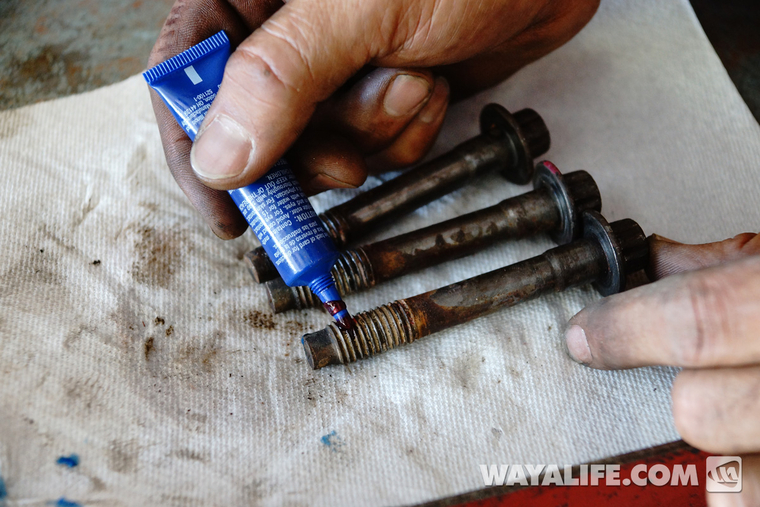

12. Clean your unit bearing bolts with some brake cleaner and a wire brush and then apply a drop of red Lock-Lite on them.

Why red Loctite, though? In the TJ world we generally use blue for just about anything that needs to use a threadlocker compound. Or course, we use more than a small dot, so I guess it works out the same in the end. Or is there a specific reason? Please de-ignoramous me! Do JK specs call for it rather than blue? Just curious... ;-)
Wade
Nice! I am doing this to my 2003 TJ this coming week. Except for the speed sensors it is pretty much the same exact deal, even the torque specs.
Wade
All the bolts on the JK use blue as well, just a lot more of it. I like to use red because you can use a lot less of it and get the same results and it does better with higher temps. At least, that's what I have found but if you'd rather use blue, by all means, please do as I'm sure that's what the dealerships would use.
