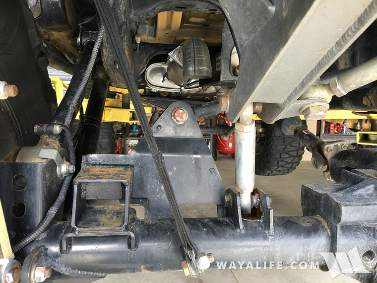

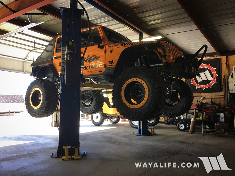

Racking Rubicat up and getting ready to swap our exhaust system.

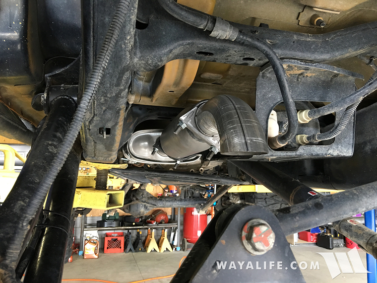

Here's a shot of the QuietCrawler Performance Exhaust System or at least, the pieces that I would be needing.

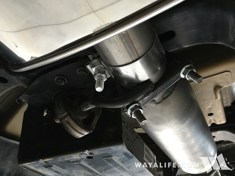

Fortunately, I already had an exhaust hanger from our old Evolution Competition kit that gets mounted to the forward bolts of the EVAP skid plate and I was able to reuse it. However, in order to use it, I had to cut the hanger and re-weld it so that it pointed inward.
Using a piece of old 2.5" exhaust pipe I had laying around, I cut it down short enough so that it could be used as a coupler between the Ultra Flo muffler and the Race Bullet. I then secured everything in place with a wide exhaust clamp. I also cannibalized an old exhaust hanger I had on an old tail pipe and welded it to a standard exhaust clamp so that it could be connected to the hanger mounted to the EVAP skid plate.
