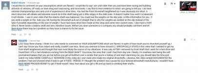

LOL - so, there's some self-proclaimed badass who's apparently a fanboy of the manufacturer of my original driveshafts and of course, felt the need to defend their honor. His name is Robert Moore and if he's someone special, you'll have to forgive me for not knowing who he is. Not sure why an Ultra 4 racer would be watching our lame ass videos but of course, I don't think he really did.

Clearly, he's not as old as that Robert Moore guy and has to be slamming them and based on false assumptions :crazyeyes:
The name sounds familiar. I'm pretty sure he's on a couple of the local Vegas FB groups and likes to belittle anyone who has problems with said company.
EDIT: nope. different guy.
