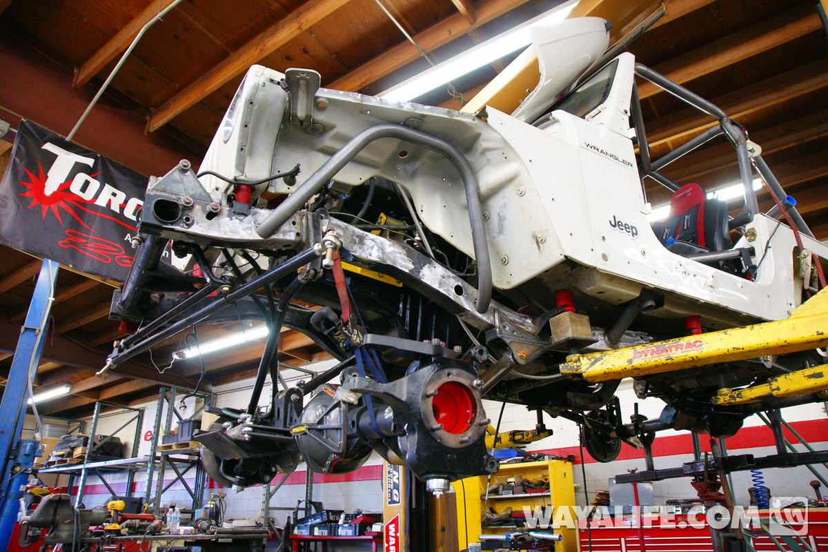

Full bump on the the EVO TJ

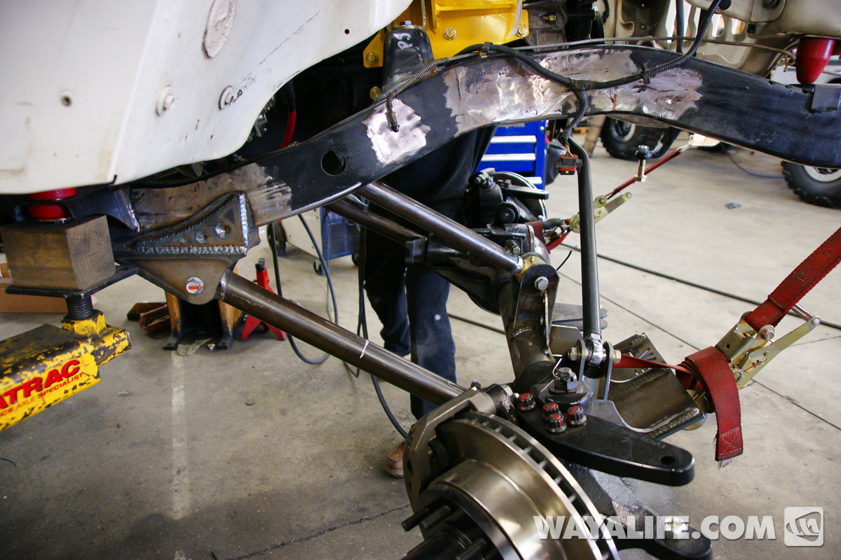

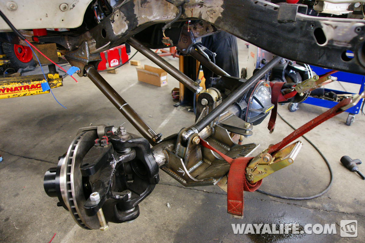

Full bump and All linked up with .250 wall links

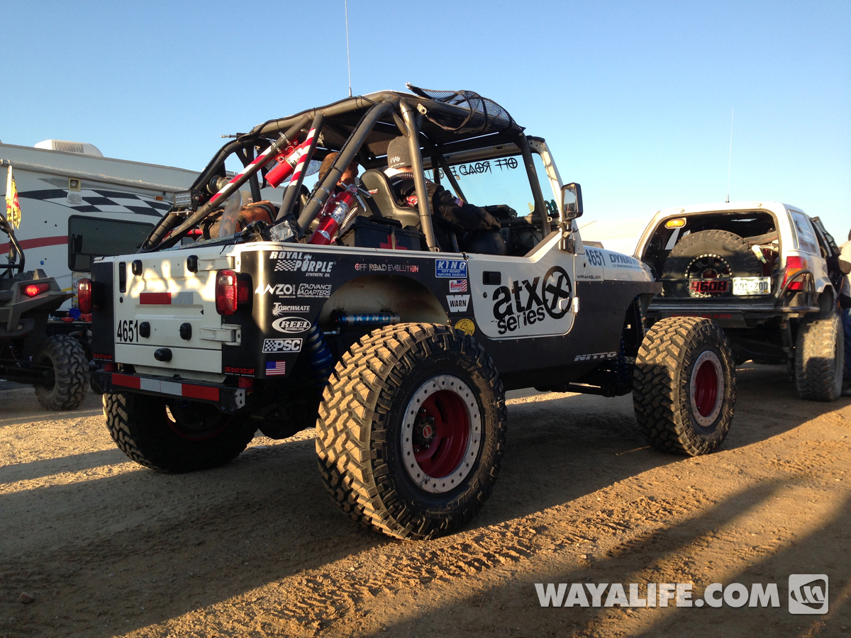

I could be wrong, but I think I just say this rig on course start. White TJ, with red ATX wheels and ATX written across the side!
EDIT: Definitely it. It's got Discount Tire across the hood.

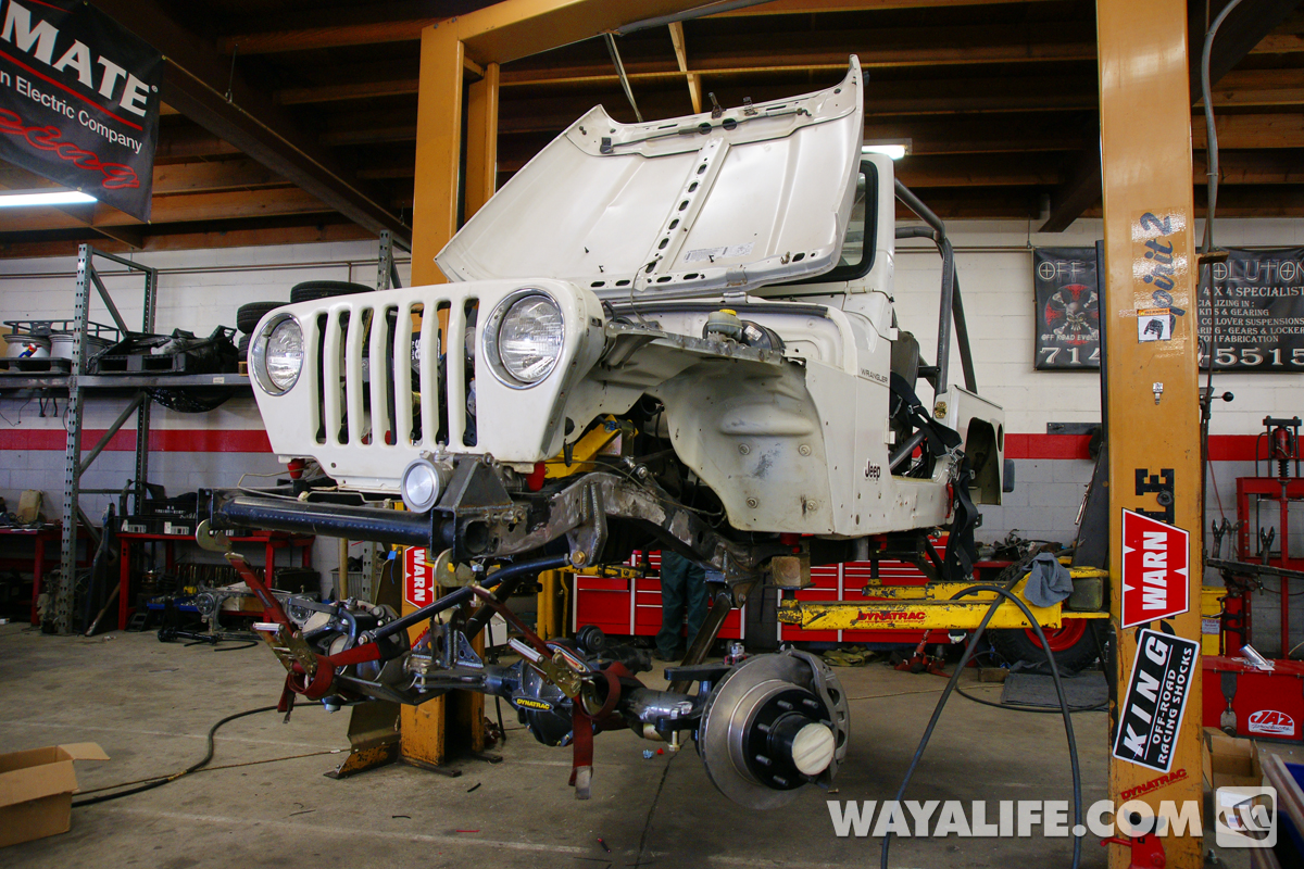

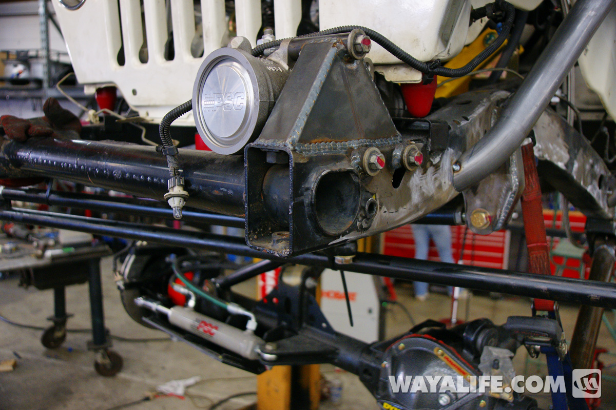

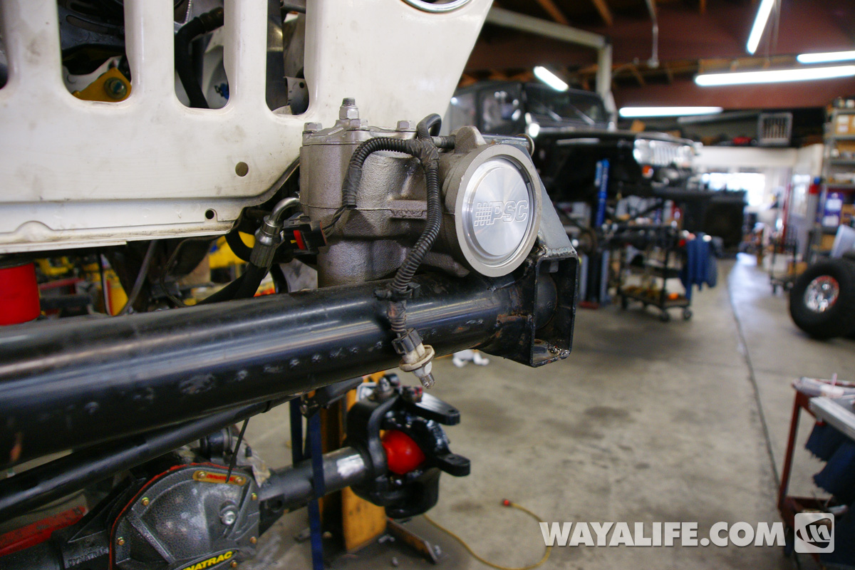

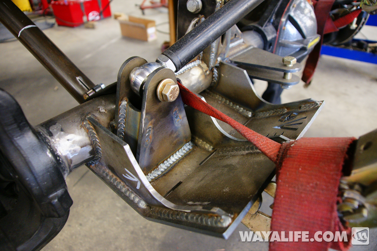

Relocated steering box

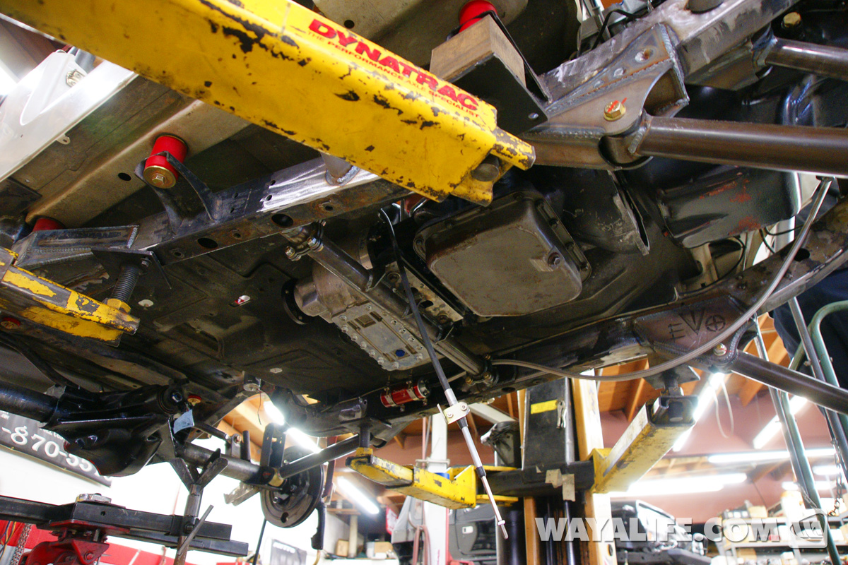

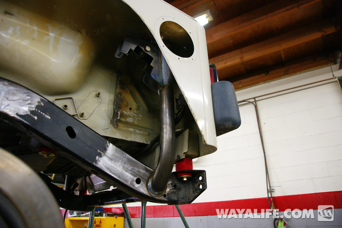

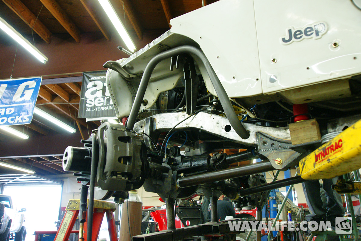

New transmission crossmember

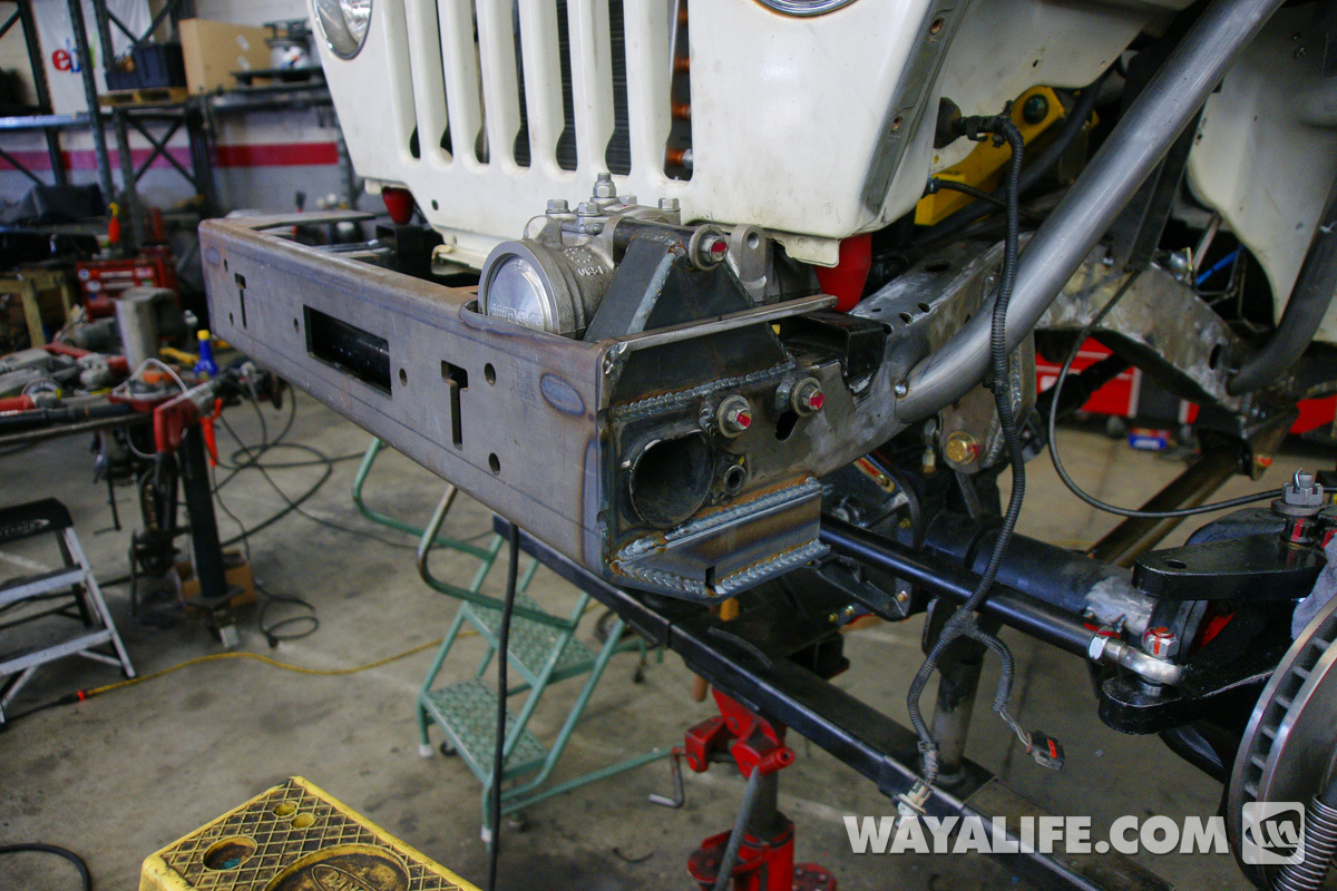

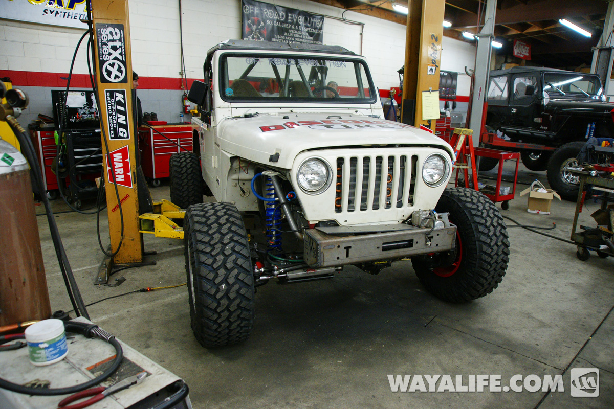

EVO custom front bumper welded on

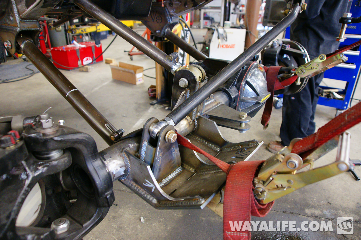

Front shock and coil mounts

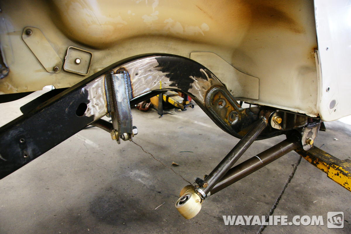

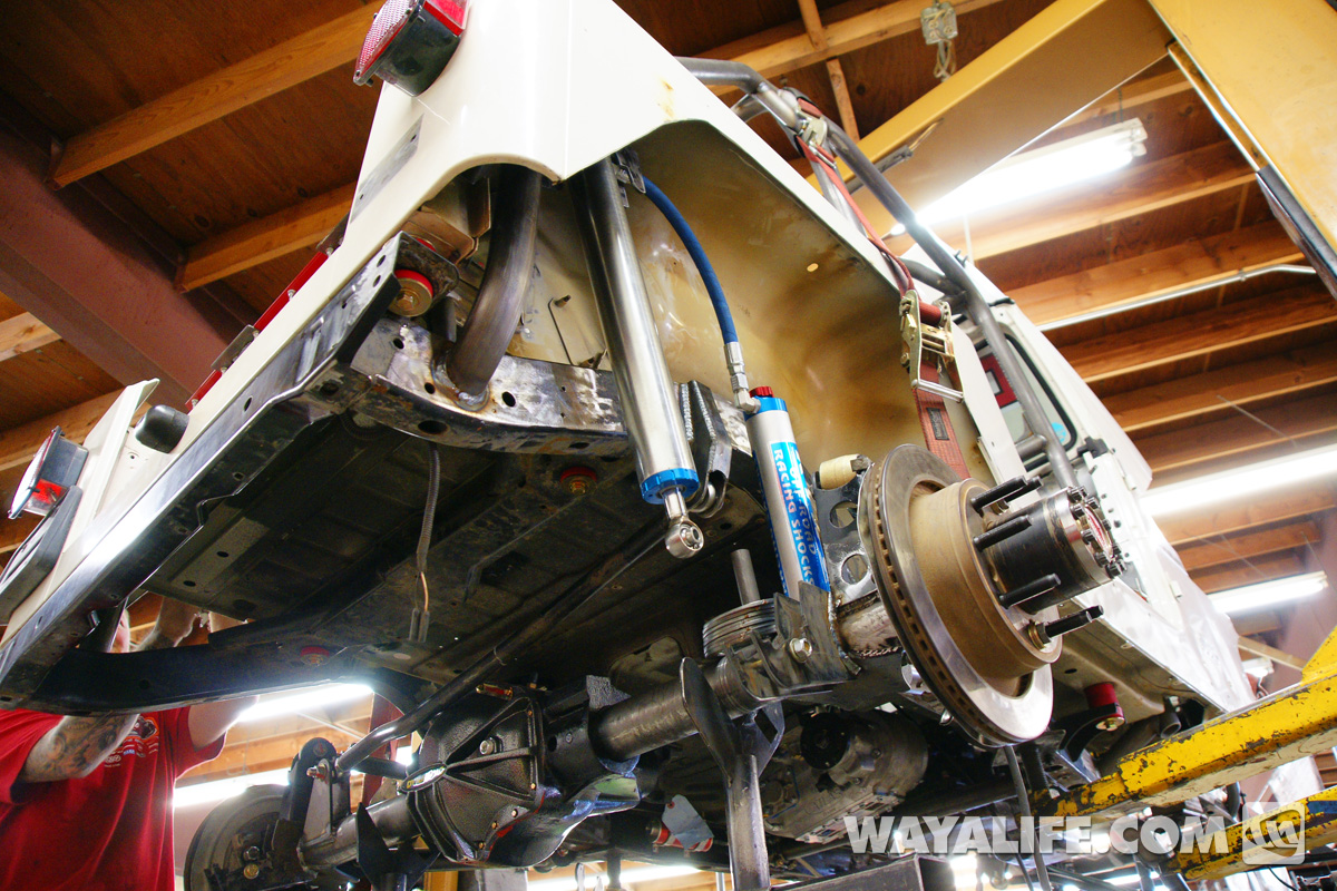

Rear shock and coil mounts

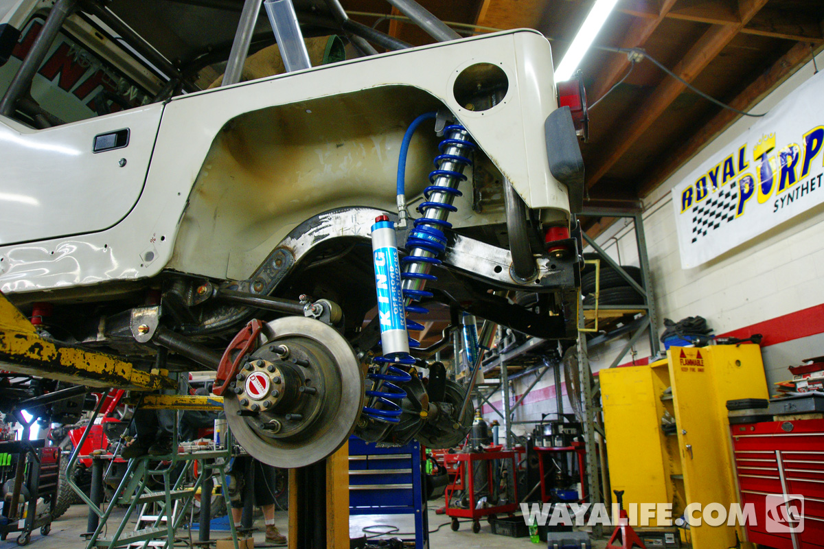

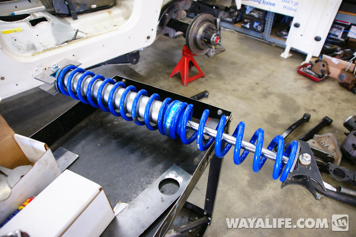

Rear coil and shock being fitted

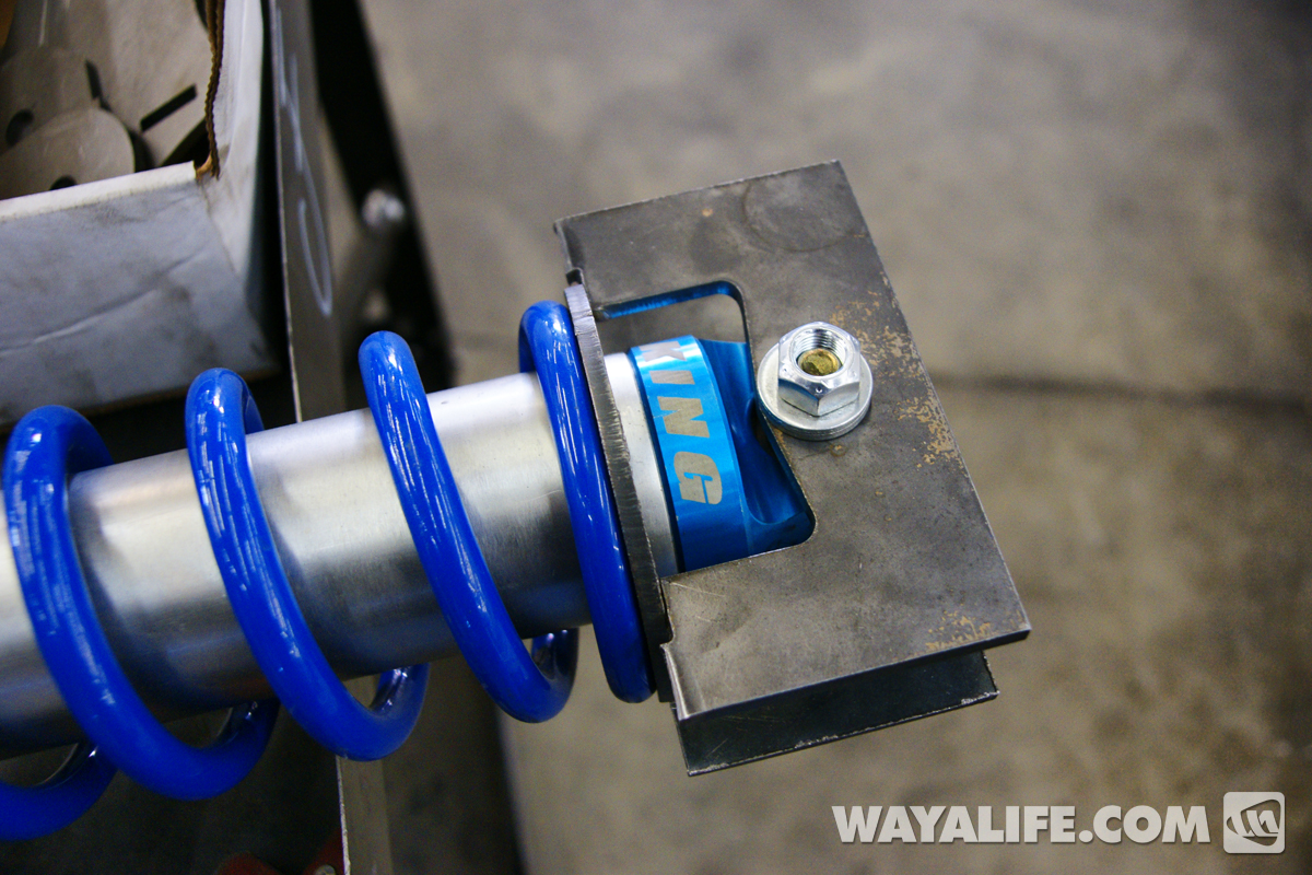

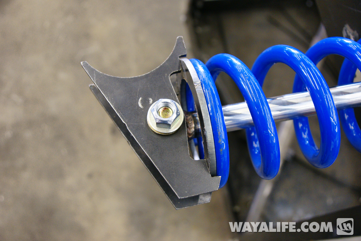

EVO coil and shock mount detail

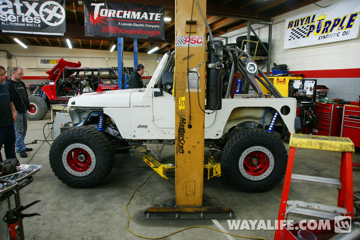

On the ground

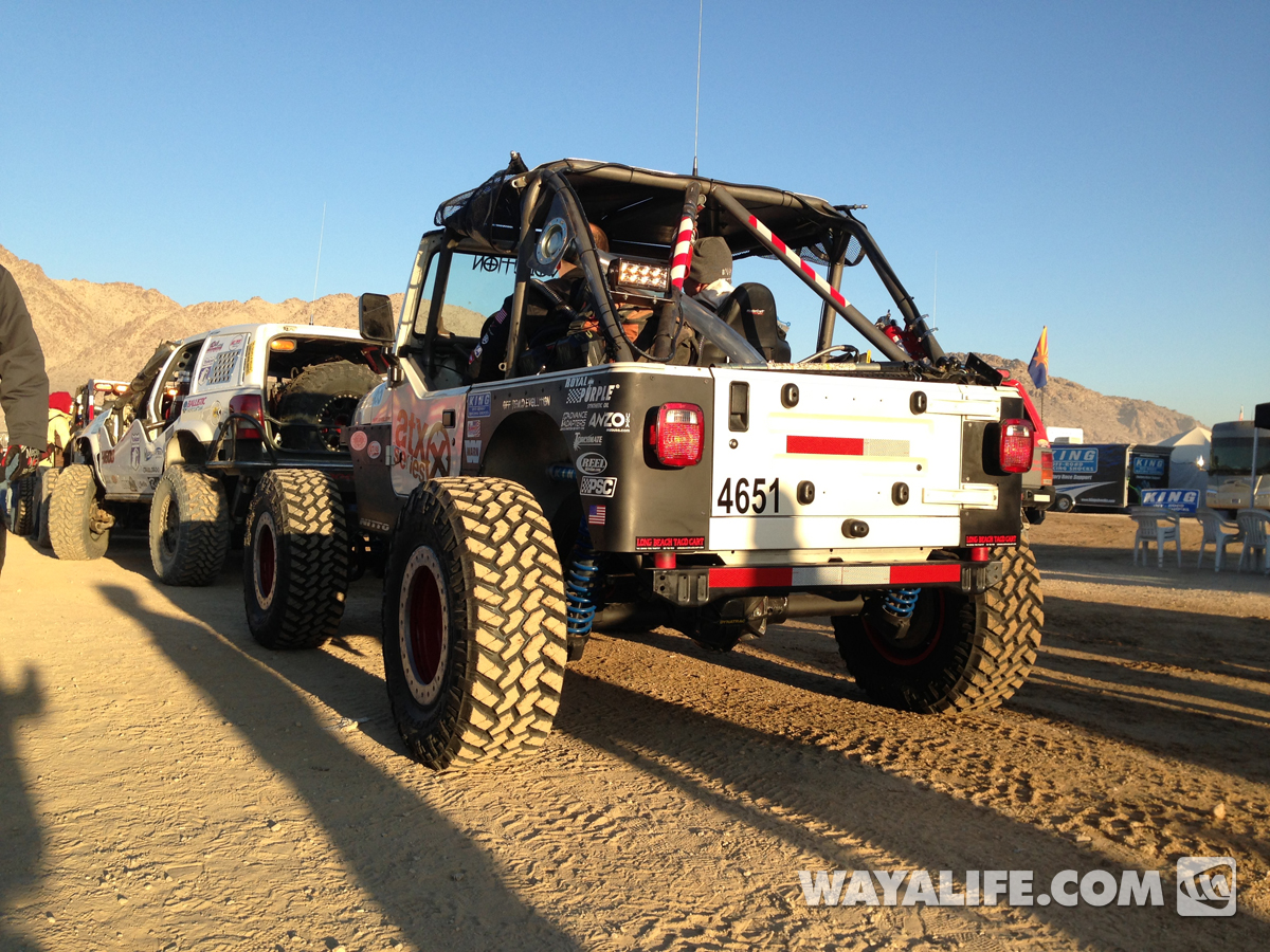

On raceday
