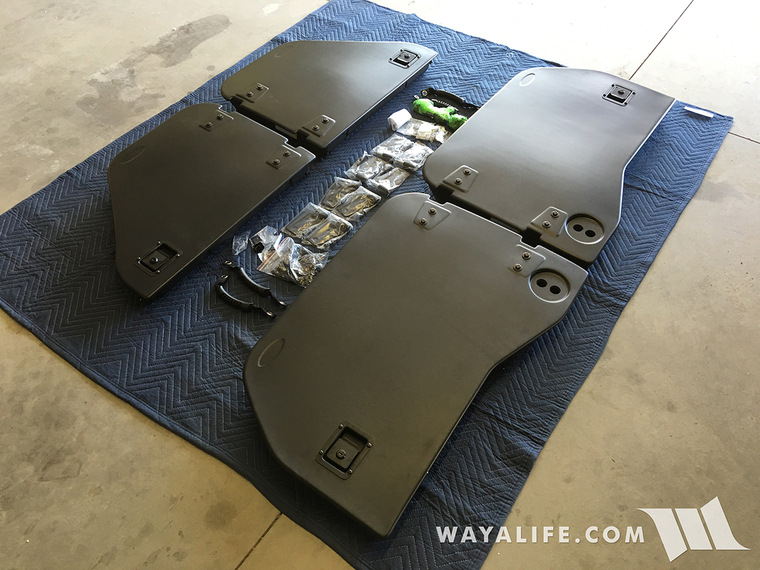

Shot of the Rugged Ridge half doors unpacked and ready for paint.

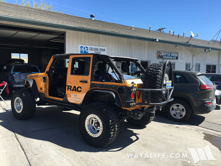

Picking up our new painted Rugged Ridge half doors (plus the one sample door we left) from the great guys over at Battle Born Auto Body in Carson City.

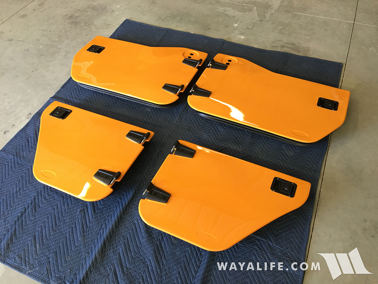

Doors all painted to match and ready for final assembly and installation.

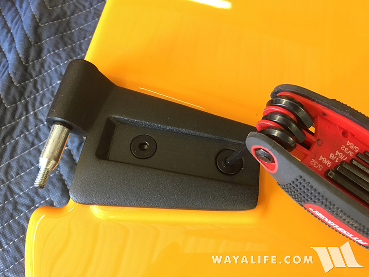

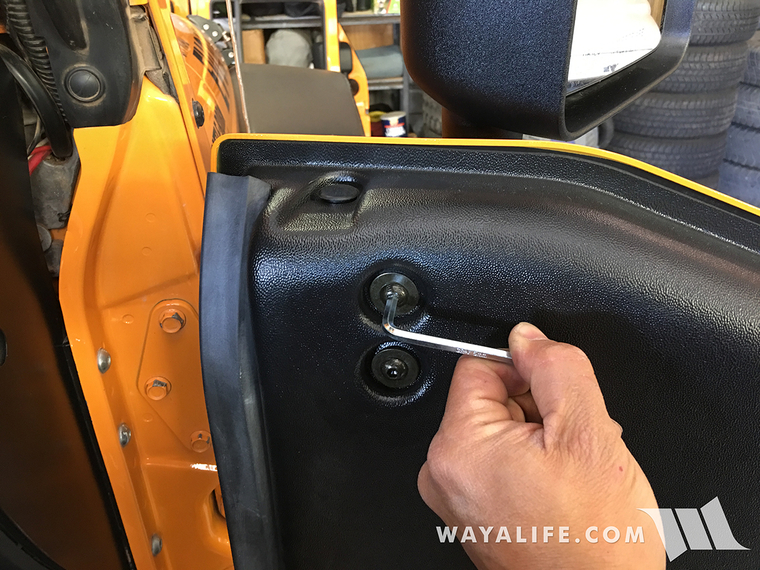

1. Remove the shipping bolts from the door hinges.
2. Use a 3/16" Allen wrench to secure the hinges to the doors with the tapered bolts provided with the kit.

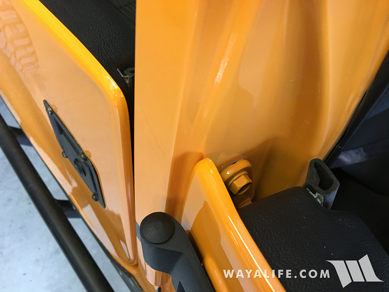

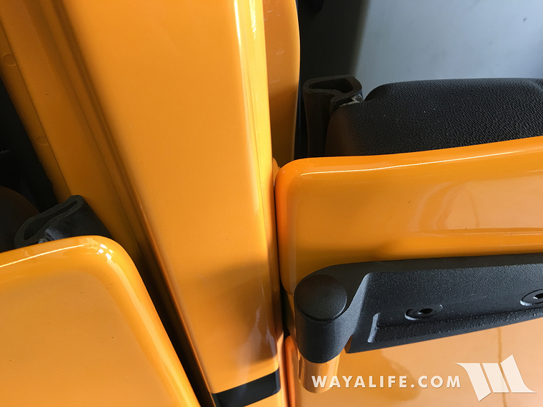

Here you can see how my rear driver side half door was making contact with the B-pillar and that prevented it from closing properly.

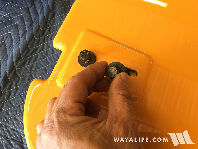

4. Using a 13mm socket, loosen the factory bolts securing the door hinge to the B-pillar and make adjustments as needed.

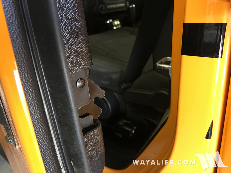

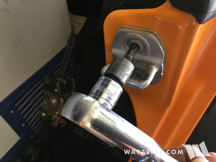

5. You may also find that the door striker will need some adjustments to allow for proper latching of the half door. A Torx T-40 bit will be needed for this task.

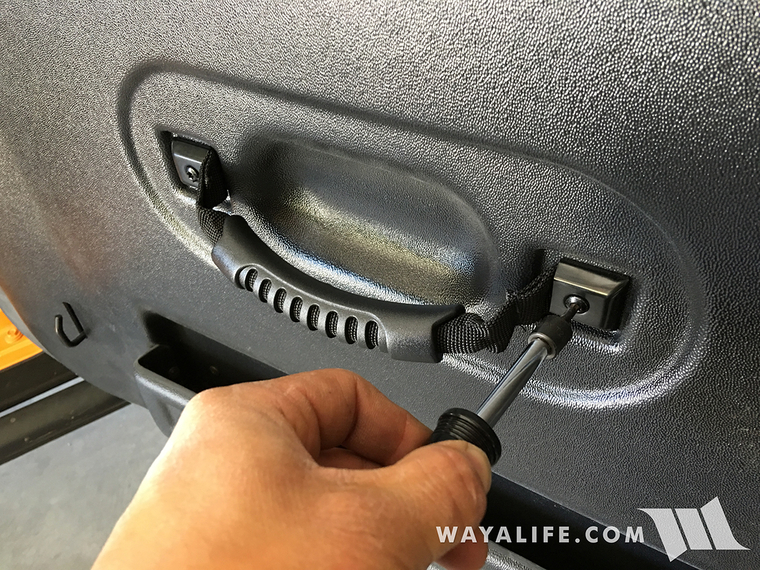

6. Using a Torx T-20 bit, secure the door handles onto your new Rugged Ridge half doors.

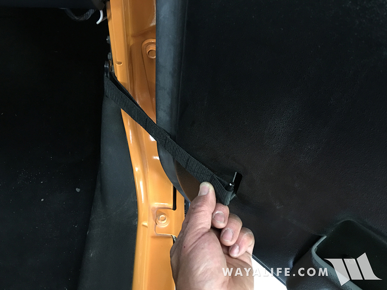

8. Finally, install the limiting straps provided with the kit to help prevent your doors from swinging out too far.

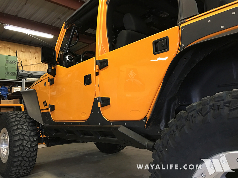

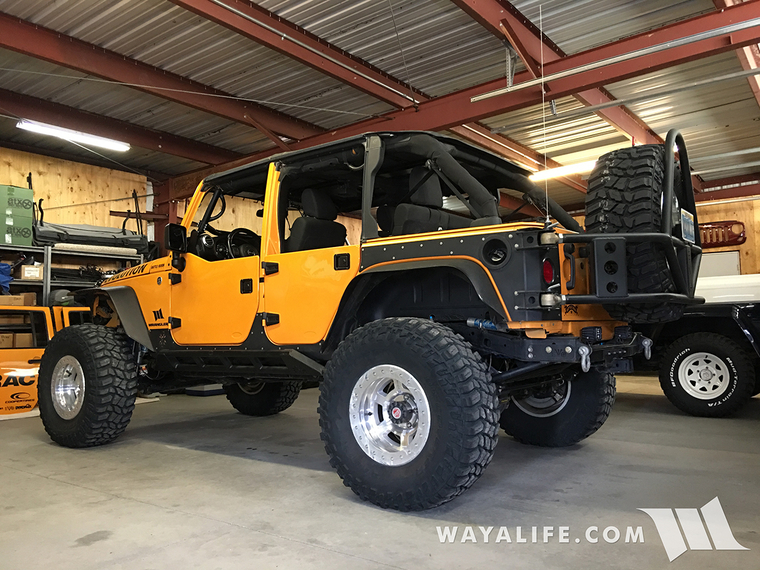

What everything looks like installed
Some close up shots.
Doors open to show you what they look like inside.
Driver side front door.
Driver side rear door.

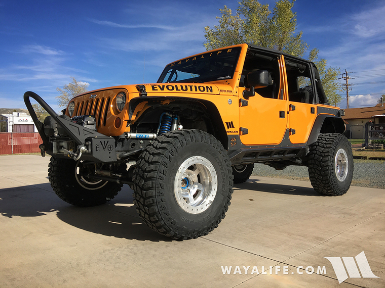

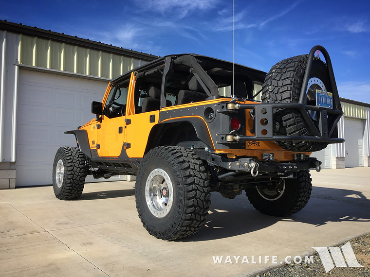

Here are a couple of outdoor shots.

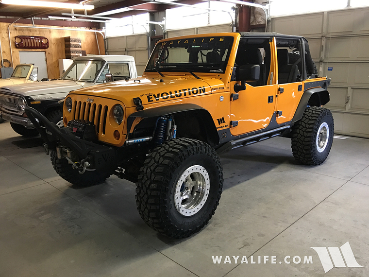

UPDATE: Here are a few shots of what Rubicat looks like with Rugged Ridge Soft Uppers installed as well as being all stickered up.
