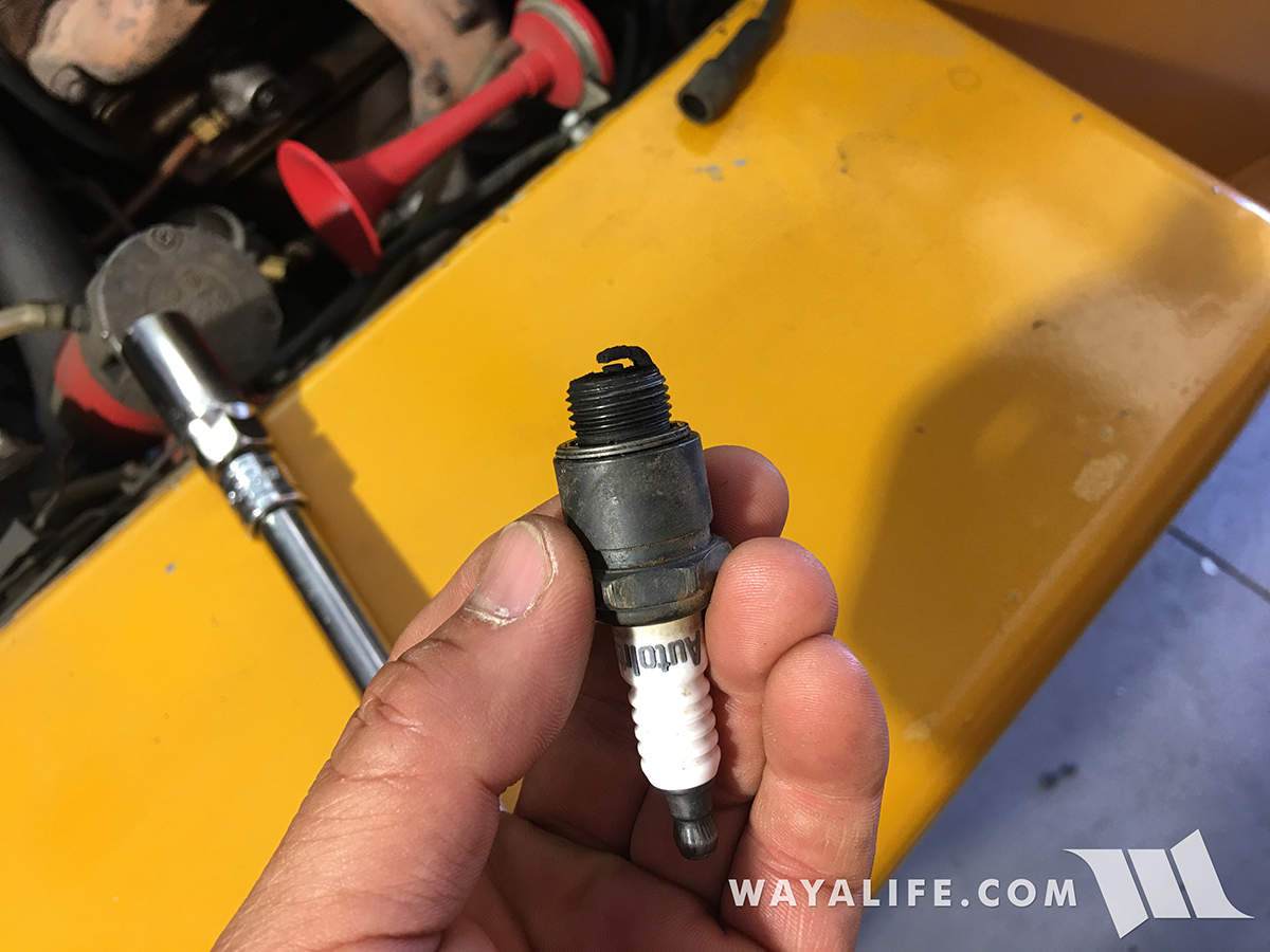

Plug #1 can now be removed using a spark plug removal socket.
Here's a shot of what the plug looked like - just a bit of fouling. :icon_crazy:
