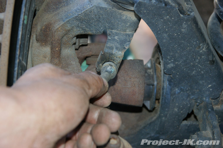

• 12 Point 13mm Box Wrench
• 21mm Wrench

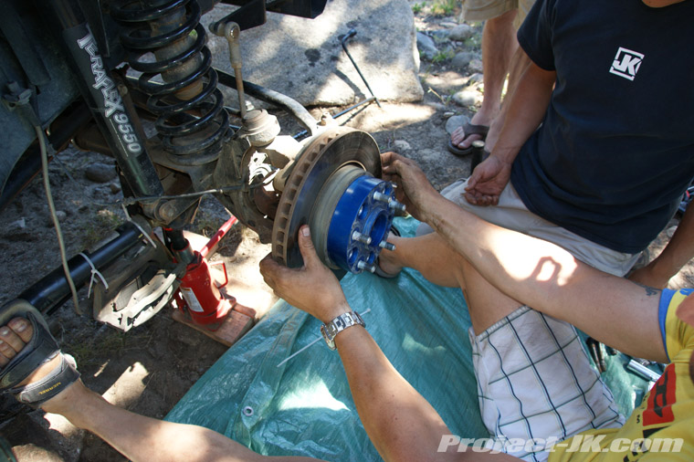

1. Using a 19mm socket, crack the lug nuts loose but do not remove on the wheel of which you will need to remove. Place a jack under the base of your front axle's control arm and raise it up until the wheel slightly off the ground.
2. Remove the lug nuts and then the wheel and set it under the frame rail of your Jeep for safety.
3. Using a 36mm socket, remove the large hub nut. If you have help, having someone step on the brakes during this process will help make it easier. If not, you can use a pry bar positioned across the wheel studs to help brace it and keep it from moving.

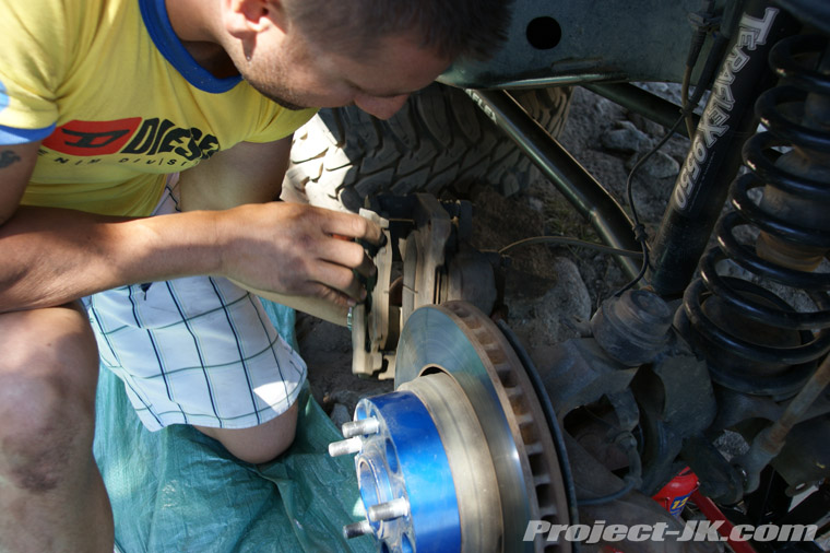

4. Using a 21mm wrench, remove the 2 bolts securing your brake caliper to the knuckle.
5. Carefully remove the brake caliper and zip tie it onto your lower control arm or frame so that it's out of the way and not hanging from the brake line.

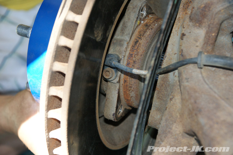

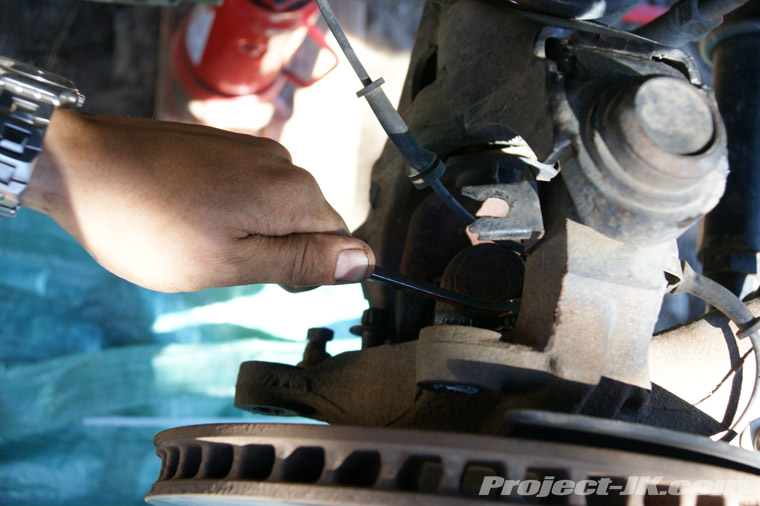

6. Pry off the speed sensor cable from its retaining clip.
7. Follow the speed sensor cable up to the back of the frame rail and unplug it. If you prefer, you can disconnect the speed sensor from the wheel bearing (shown below) instead using an 8mm allen wrench.

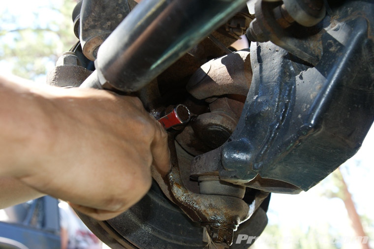

8. Using a 12 point 13mm wrench, remove the 3 bolts (2 above and 1 below) securing the hub/wheel bearing to the knuckle.
9. Remove the rotor, dust shield and hub/wheel bearing and set it aside.

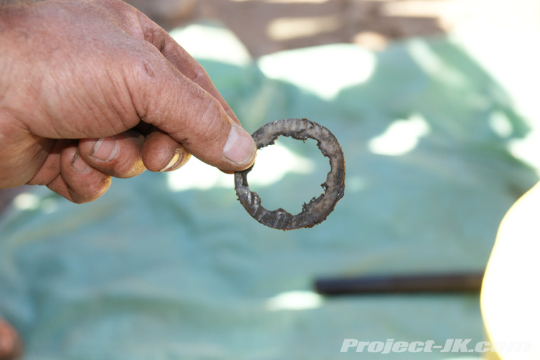

11. If it didn't come out with your axle shaft, you will need to look inside your axle tube and phish out the plastic shaft guide as it will prevent you from reinstalling your old shaft or installing a new one. This guide is not needed and can be discarded.
• 21mm Wrench
