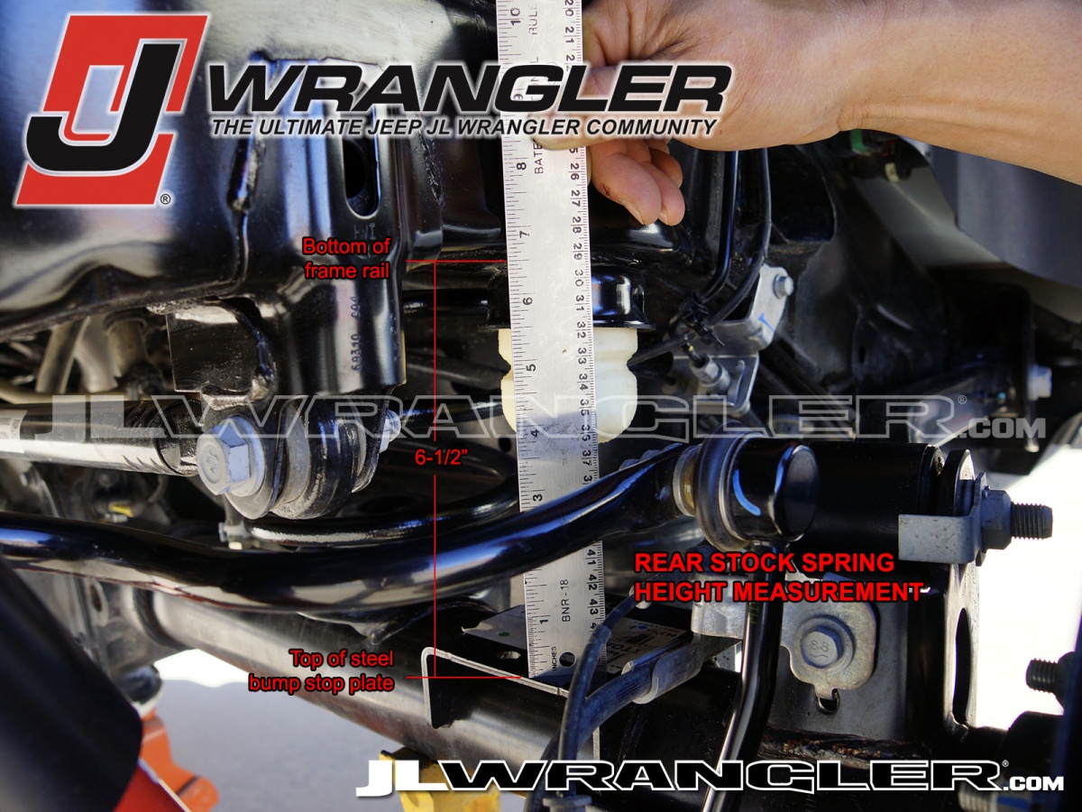

STOCK REAR MEASUREMENT
On the rear end of our JL Wrangler, we took our measurement from the bottom of the frame rail, just behind the bump stop cup and down to the steel bump stop plated located on the axle. As you can see, this gave us a measurement of 6-1/2".
After installing a suspension lift, all you need to do is take measurements from these points and the difference you'll see will be the amount of lift your kit actually provided. It is important to note that new coils will tend to sit MUCH TALLER soon after being installed and for more accurate results, you'll want to let them settle in a bit before taking these measurements.
