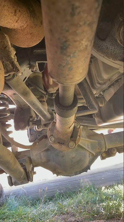

Lately I’ve noticed some clunking every now and then while driving at slow speeds when slowing down and speeding up (such as through a parking lot). It’s not consistent by any means. I’ve been searching for the noise and recently noticed this. I was wondering if this is normal….
Looks average to me. You’re rotating the pinion from the drive side to the coast side of ring gear. I don’t see anything excessive.
