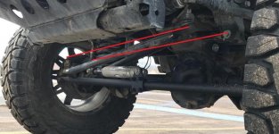

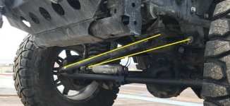

On a computer, you really need a pic so you can see all end points of both bars like these pics:
Like WJCO said, The parallel test is an invisible line between the end points, not the bar itself. Take a head-on photo, with no angle, and all four joints visible. Then get on your computer and draw two lines between the joints. That will tell you what is going on.
If the lines are off, the vehicle will shimmy over every bump. Even one inch off will have you constantly correcting just to stay on the road.
Are you having bump steer now? If not, I wouldn't mess with it. Truthfully, your angles are already pretty close to parallel. The flip will just make them less steep.
Here's where you're at now:
And here's approximately where you'd be with the flip:
