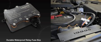

My Gladiator did not come with the 4, prewired AUX switches, so I installed the aftermarket LASFIT switch bank. Easy install, comes with the 4 leads inside the cab and 4 near the battery, like OEM. Right now my KCs are wired to buttons 1 & 2. The LASFIT switches are rated at 30 AMPS each, is it safe to assume I can wire my single ARB air compressor to switch 4, the compressor draws max 25 amps under load. Obviously. I'm not an electrician. Thanks.
