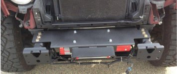

Getting ready to pull the trigger on a new Warn VR8000 or New "and Improved" VR8. I found some pics on the interweb that show some clean looking hidden mountings inside of stock JK bumpers. I like the look and i'm handy enough to make it happen but have a few questions:
Any known issues with mounting the winch upside down?
Any issue with having the clutch lever under the bumper other than convenience (lack there of) and a dirty clutch handle?
Anything thing else I should consider?
Here are a couple of pic for reference:
With VR8000:
With VR8:
I would make a custom mounting plate from 1/4, 5/16 or maybe even 3/8 thick steel and bolt it directly to the top of the frame extensions with a machined and bolted fair lead extension, kind of like shown:
Let me know what you guys think!

only issue I could see with the clutch lever on the bottom is maybe hitting it on a large rock. I do think the hidden winch looks badass tho so I hope you can pull it off

My only concern would be, since the new VR8 has an integrated solenoid box, would that hit/rub/interfere with the crash bar?
I'm planning on leaving the crash bar intact or just cut away enough to allow the lever to swing freely with a little hand clearance. It should be somewhat protected all be it probably a PITA to use:
Love the new VR series, if I didn't get my gen 1 VR for half the price of the gen 2s, I just would have bought a gen 2! Hah.
I looked into this and like the VR8000 it can be removed and relocated. I'm thinking under the hood.

I looked into this quite a bit and in the end, to me it wasn't worth it. No matter what DIY you do it will involve drilling/cutting into the frame. Choose the wrong hardware and you'll do a lot of damage when you needed your winch the most.
Plus the crash bar doesn't hold up well to hits. I've barely bumped mine and it's frowning pretty good now. You will damage the lever if you leave it there.
Rock Hard 4x4 makes a nice top mounted winch plate for the stock bumper.
sipafz
Thanks for the good advice! Unfortunately, I like hard! The frame already has one hole (circled) and I plan to drill a second hole (arrow) so I think the impact on the frame is minimal. On the front frame plates, I'm planing on slotting between the holes (parallel lines) so I can get grade 8 hardware in place and properly tightened:
Your right about the crash bar not being the most rigid thing in the world. It's a risk, but my off roading is light. Maybe I can beef it up?
I looked at a lot of different solutions including the Rock Hard plate. They all accomplish the goal, but I just like the hidden look. I'm probably going to order my winch from them because they have the VR8000 on sale for $400, they support the forum and they periodically do those sport cage giveaways which is really cool.

With the winch that hidden, how are you going to spool it properly? Seems like it'd be a pain in the ass to look up underneath the bumper to make sure you have the rope feeding right.
Well, I have absolutely no experience with spooling an automotive winch, but I have spooled an overhead 10 ton hoist once. We started by lubricating the rope with grease and then let it spool it self under a light load. It was quite easy so I really didn't consider it to be an issue. Time will tell!
