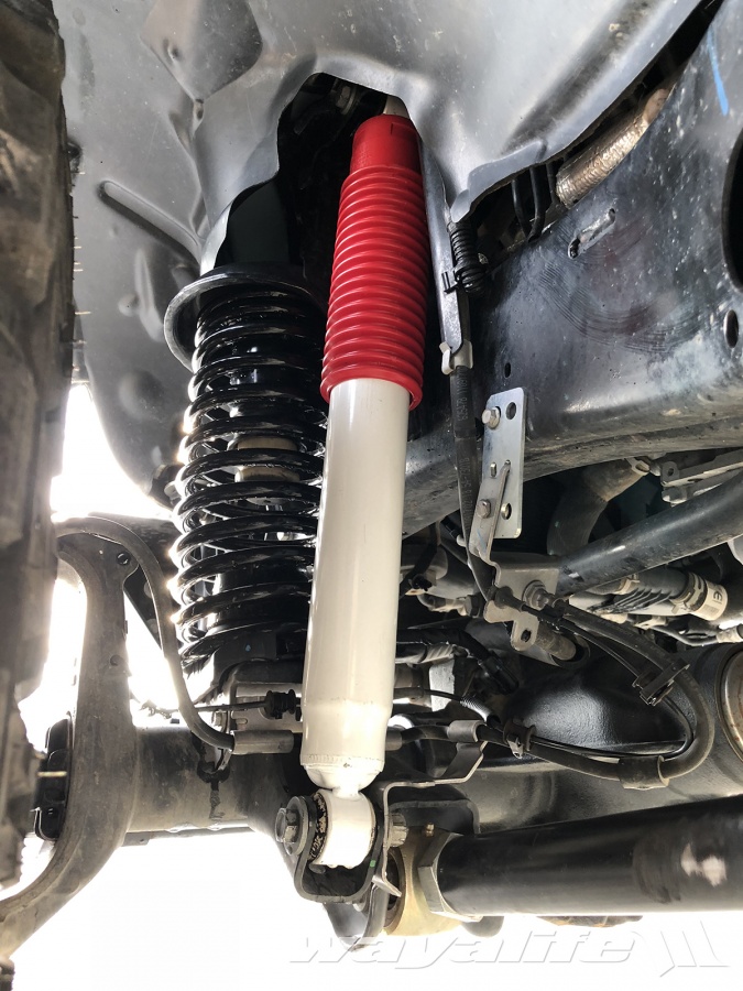

Here are a few shots of what the new Rancho springs and shocks look like installed.
