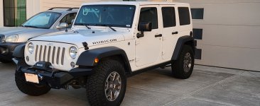

Got my winch put on. I am working with a friend who has access to a CNC Mill. We are going to mill out some aluminum blocks to allow the license plate to sit vertically and place the license plate below the fairlead as I don't really like how the license plate currently is mounted.
