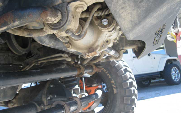

I love my EVO quarter pounder bumper on my JT. I recently acquired a JL. Wanting to run the same bumper. However, on my JT I installed a front Anti Rock sway bar. On the Jeep JL I'm keeping the facotry sway bar. Will this Sway bar flip kit work with this EVO bumper?

I just did what it says in the EVO instructions on page 10...
https://www.dealer.evomfg.com/technical-docs/EVO-3057.pdf
Basically:
Remove the mounting bolt
Rotate the sway bar motor
Use a 1/2" drill bit marked with tape to only drill 1/2" deep
drill out the other hole
reuse the factory bolt into the hole you altered.
Been working fine for four years and didn't cost a dime.
