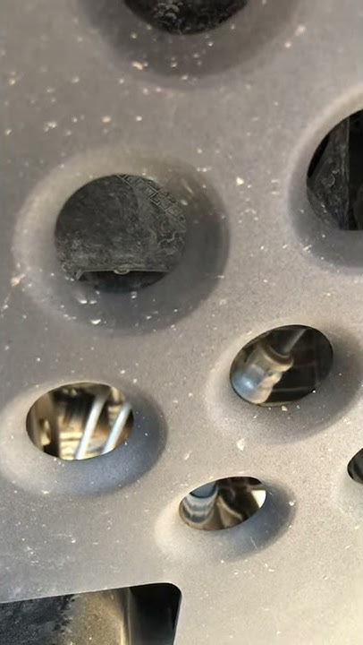

Hi,
please listen to this video, I think I have a bad rocker, I'd like a second option.
Thanks for listening!
Please let me know what you think.

jeepabout
Could you post a couple more videos of it? Maybe from either wheel well? I feel your fuel injectors might be muddying up the possible ticking noise.

it's pretty consistent.
Before your next oil change run some seafoam or marvel mystery in the oil, see if a quick clean 100 miles or so helps it at all. It doesn't sound damaging or anything super bad, but there's definitely noise. Wont hurt to run the cleaner through with some gas as well if you suspect injectors are dirty.
