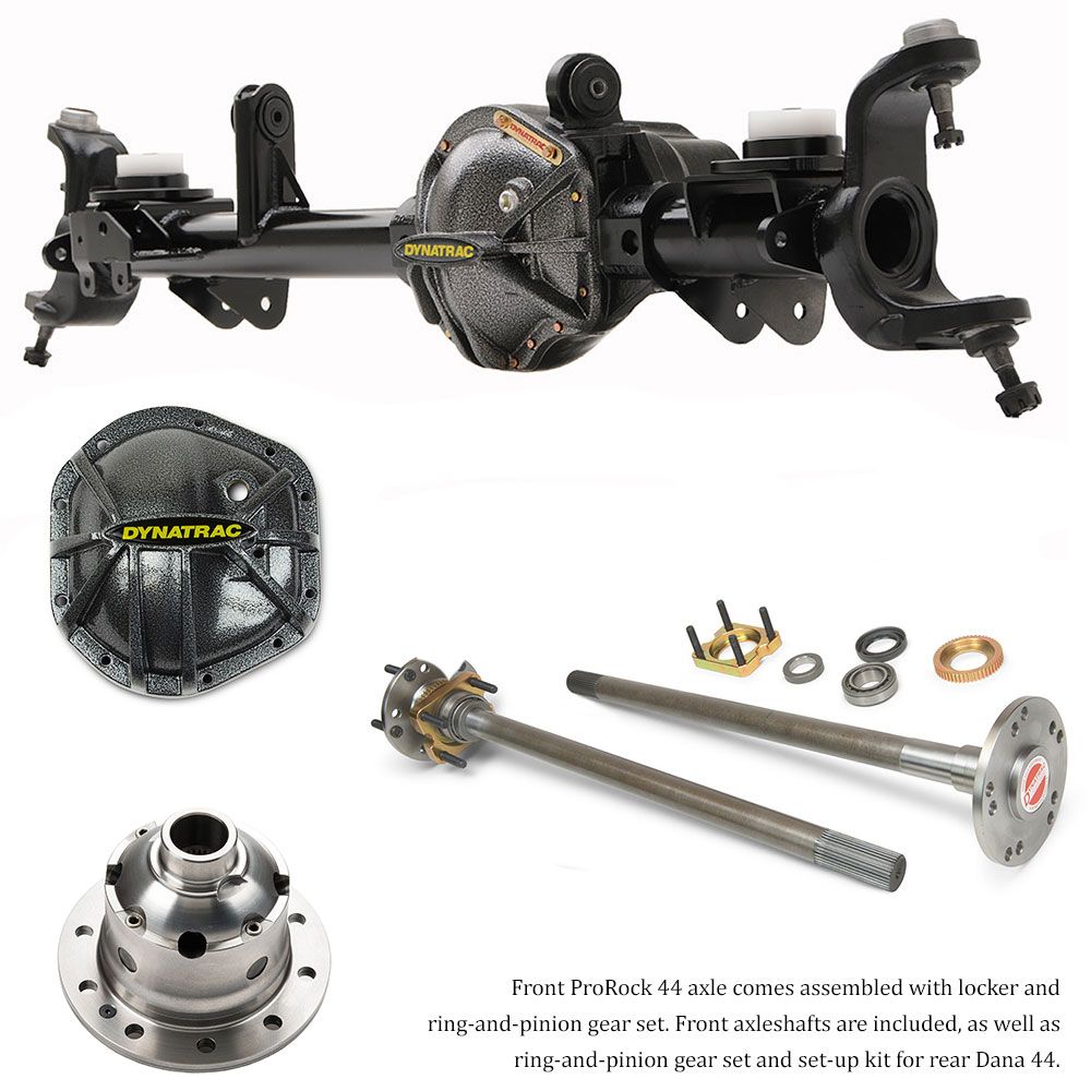

im not sure about dropping $5k on a Dana 44 for the front. It really isn’t much of an improvement over the Dana 30. For a few bucks more, you can get a built ProRock 44. Consider something like the Dynatrac trail leader package, which gives you a built ProRock front, and a locker and chromoly axle shafts for the rear.
Forgot about the trail leader package considering he doesn't have a Rubi. That's what I'd do with $5k

Contact Carbon, they built their version of Trail leader for me. Granted, the front axle isn't the exact size of the pro rock, and there was a promotion from ARB, so I got the compressor for free, but the entire package was about $1200 less than Dynatrac.
